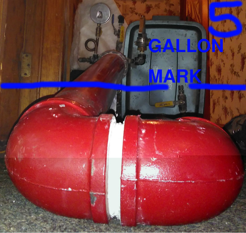

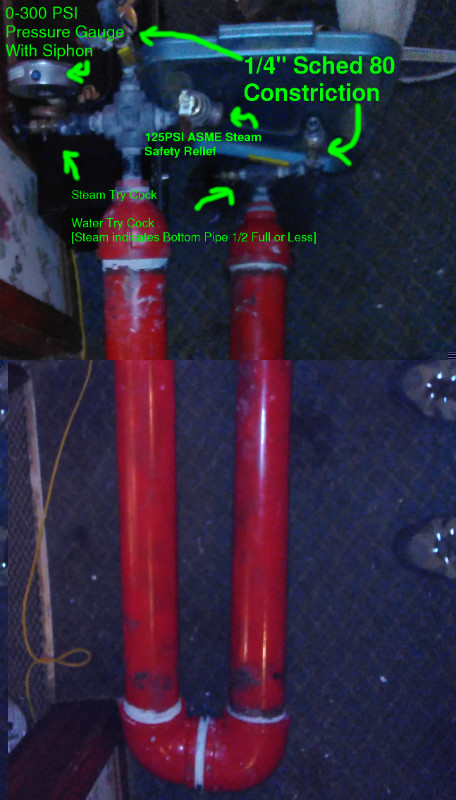

So this is what I am looking at trying, there is a shallow angle. Right now a black tool chest is supporting it, but I will add a leg so that it sits as shown.
KPV parameters met:
1) This should allow the PV to slip in as a passengers legs in a 2 person kayak depending on how much insulation is used.
2) 5 Gallons fits with a generous steam dome. No internal baffles.
3) Two ports will allow experimentation on filling.
Safety parameters met
a) 125PSI MAWP Pressure Vessel. All pipe and fittings rated for 150PSI SWP or higher.
b) 1/4" restriction on the two valved swagelok ports + 125PSI Steam Safety Relief valve accommodates incoming 200PSI steam/water.
3) Escaping steam/water should flow towards the 4" elbows for passenger/crew safety
Next up is a hydro at 1.5x MAWP at 225 without the safety valve.

The PV hydro of 250psi, which is 2x the MAWP of 125PSI.
Next up is to add a some mechanical support, and then an uninsulated steam test.
Fred, please share your thoughts before I apply steam.
