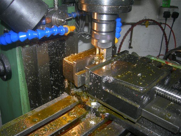

Yes, I've actually cleared my feet of other things, and had a couple of hours on this. Actually I'm awaiting delivery of some items for another project and needed a diversion, so I took another look at the con-rods and in particular the small-ends. After careful measuring I decided the slots so carefully cut before, were not deep enough by about 3mm so I reset them in the mill and cut them deeper.

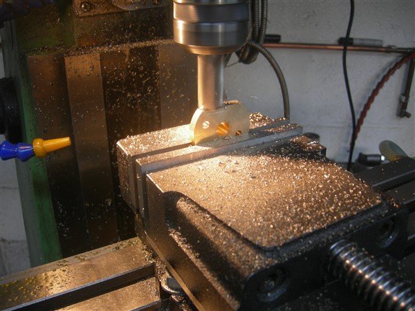

Having made the blanks for the cyl. glands some time back I thought it time to finish them off, now the other project is complete.
A cross-line was marked in the lathe, and the centres marked with a vernier. Marking out completed, the shape cut on the mill.

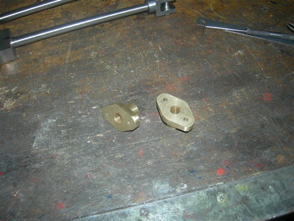

Corners dressed off with a file, job jobbed.

No biggie, just another step, and a quiet afternoon in the workshop. The small-end yolks are next for rounding, having been cross-drilled and pins made to fit.

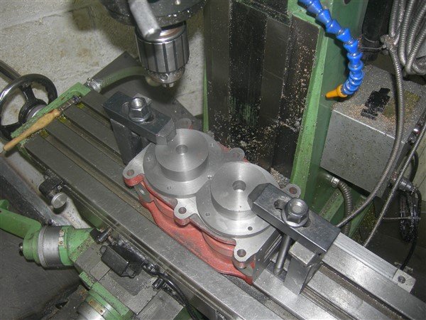

It seems that 'catch up' is the best game in town. A little job that has been hanging fire for some time was to drill the fixing holes in the bottom covers. Normally reasonably simple with the DRO, except it decided to throw a 'wobbly' and refuse input, and then refuse to follow sequence. It is 18 years old, and Chinese, should I be thinking of a new one? Perhaps I should just use it more often?
However, I eventually showed it who is Boss (Not with a 2lb hammer, though sorely tempted!) and managed to drill the required holes, and in the required places, 5 for each cover, Less than the number in the top covers (8off) because these will not be seen in service.
