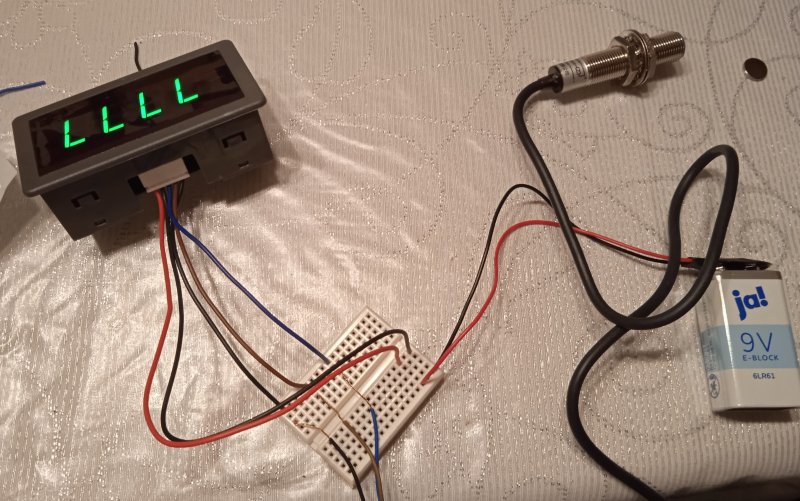

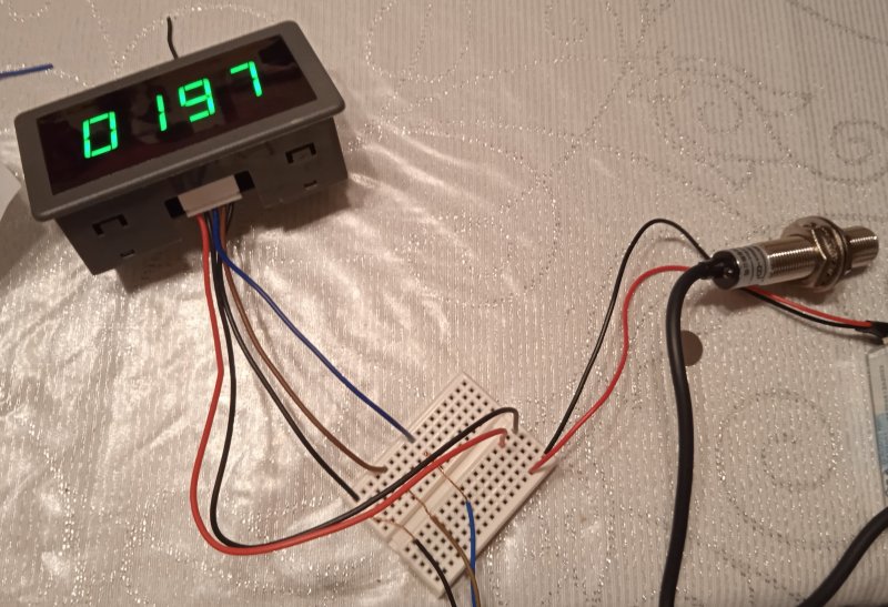

Re: Steam Thistle Cluaran
Hi,
i received all the parts and checked their function using a breadboard.
I swung the magnet past the sensor by hand to check the display. That worked.
Tomorrow I will mount the setup on the lathe to check the accuracy of the gauge.
The 9V battery will be installed in the case. Then there is the switch for the supply voltage of the tachometer.

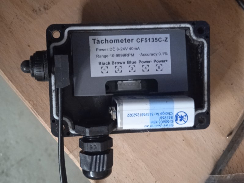

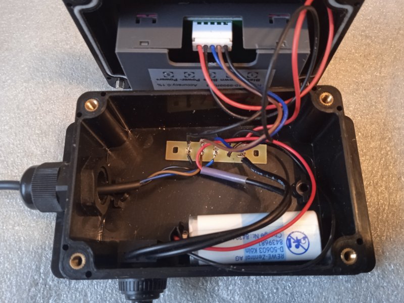

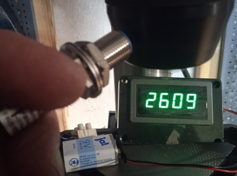

- Posts: 290

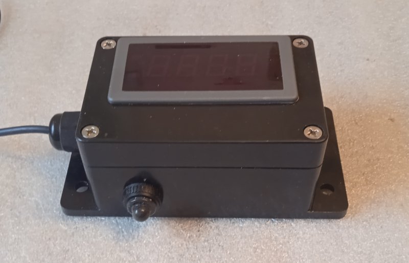

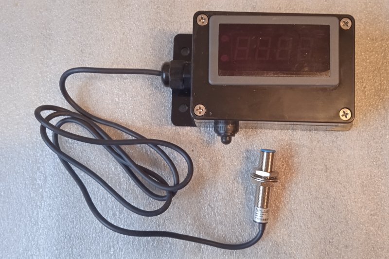

RPM-Display finished
Hi Russ,
the RPM-display is mechanically and electrically finished. It was successfully tested for function on my Variospeed drill (OPTIdrill DQ20V).
The overall view The arrangement of the components in the housing The wiring using a solder terminal strip

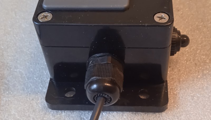

- Posts: 290
Some more pictures.
The waterproof on-off switch on the bottom of the case.
The watertight cable bushing on the left side of the housing. At the same time, it is the strain relief for the cable to the sensor. The function test on the drill A short video is available - https://youtu.be/amB2uzrcn6g
Hope it enjoys and is helpful for anybody who wants to built such device. I will use it at all my different engines, which is why I will build universal mounts for the sensor and display.

- Posts: 268
Dietrich:
Delighted to see your finished RPM meter!
It looks really well laid out and constructed, as we expect from you.
Hopefully it will meet your needs.
And we have now shared two versions of this device, for others to copy and modify.
Time to steam! (...except for the continued snow outside...)

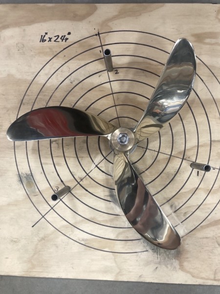

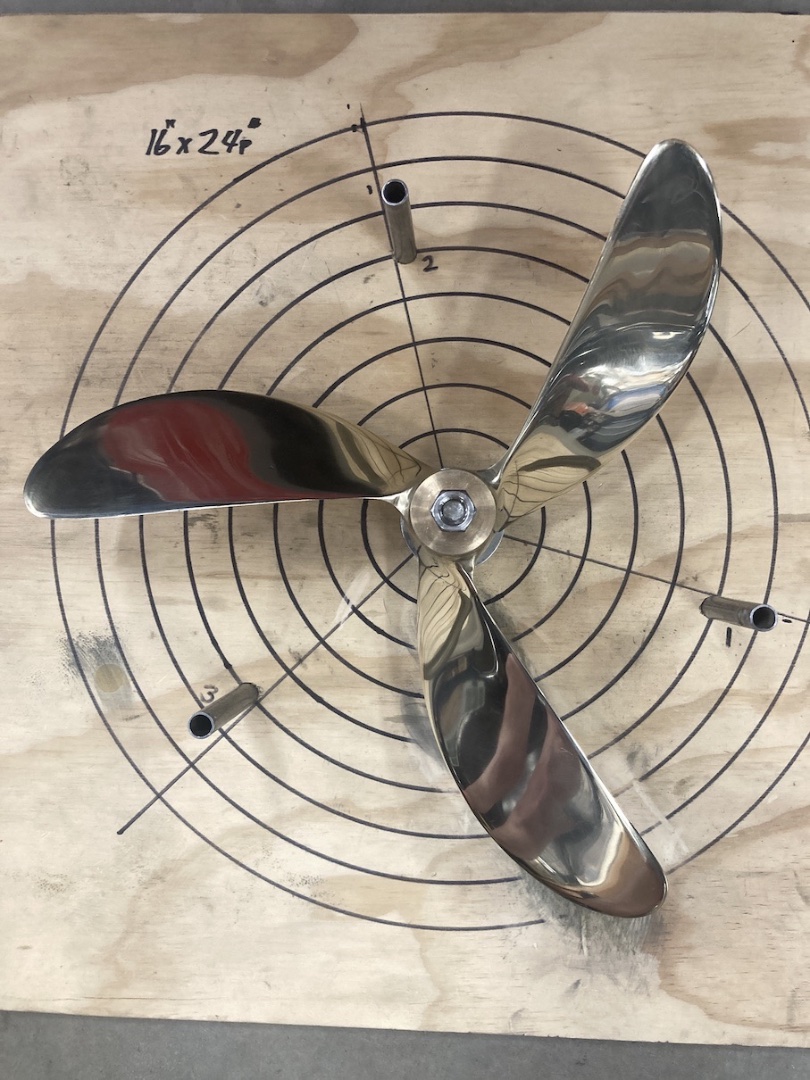

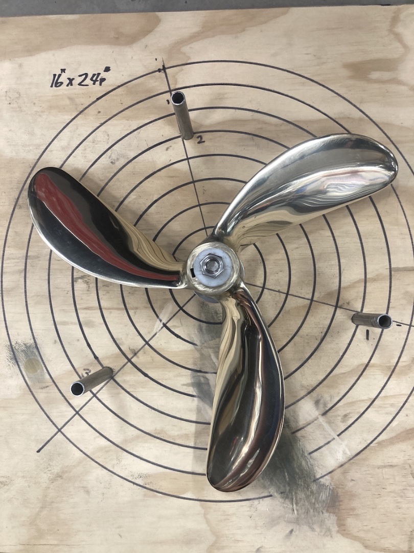

After many working hours over the past month, I finally finished the new rough sand-cast bronze 16" diameter x 24 pitch steamboat propeller,
sold to me by Pat Spurlock of Elliott Bay Steam Launch Co, in Portland, Oregon, USA!
It's now a Tylenol afternoon for my shoulders.
Pics attached (of the prop, not my shoulders...)
Next is to make boat performance tests of the old prop, and then repeat for the new prop. 'Should be fun.

That looks wonderful. I would never have thought of putting chrome plating on it, but it looks fabulous.
It will be interesting to see your performance data so good luck with the tests. I am intrigued by what one would need to do. No doubt it will be ingenious. I am still surprised that I was able to weigh Frances Anne with bathroom scales after advice from this Forum, so I am anticipating something equally amazing.
