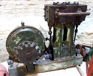

I have actually seen a steam engine on "preston services" called a "Barring engine", the description stated that it was used to turn over lerge stationary engines. not sure if this was to remove it from tdc or bdc and whether it was used only for factory engines or marine as well.
maybe that answers your question.
here is a picture of it
- Barring_Engine.jpg (29.04 KiB) Viewed 14098 times

Re: Musings of an Idiot
Folks,
Large marine engines were fitted with barring engines, usually referred to as “turning gear” on a ship. There primary function is to move the engine to a specific point for maintenance for example lifting out a piston, Turning gear is essential to avoid the engine moving and injuring anyone in the “works” It's also used to set the valve timing etc. and to turn the engine when warming through prior to starting to remove any water etc. Medium size engines use a hand ratchet worm wheel set up but large engine use a steam engine or nowadays a motor driven unit, either way the gear should had a fool proof way to disengage before attempting to start the engine, some spectacular damage has been caused when this has not secured.
Photo shows the turning gear of a very large engine used on a certain ship built in Belfast.
Jack.
Jack.
