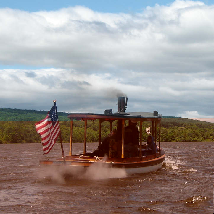

TYPICAL STEAM LAUNCH HULLS - Propulsion Power Required.
Hull design can (and has) occupied entire large textbooks, but for typical Steam Launch practice, some simple relationships are useful for rough quantification of propulsion requirements.
The basic rules of thumb state that a well streamlined displacement type hull will have a maximum hull speed as a function of the waterline length:
Maximum Hull Speed (Knots) = 1.34 x Square root of Waterline Length (feet)
Some slender hulls can do slightly better, and a more box-like hull will do worse, but this approximation is reasonable.
To drive the boat at “Hull Speed”, requires 1.25 to 1.75 horsepower per ton (2240 pounds) of displacement. In general this relationship requires a propeller of good efficiency, which translates to a large diameter slow turning propeller. Launch propellers should have a diameter equal to 10% of the boat’s waterline length, and have a pitch equal to, or slightly larger than the diameter.
The relationship between speed and power, up to the maximum hull speed, is a cubic function, which means low power does not hurt boat speed as much as one might think. An example here illustrates this phenomenon:
Steam Launch, 19 feet long, waterline length = 16 feet, Displacement = 1 ton with all supplies and passengers aboard. Hull speed = 5.3 knots, Horsepower required = 1.75 HP.
Speed, 5.3 Knots HP = 1.75
Speed, 5.0 Knots HP = 1.47
Speed, 4.5 Knots HP = 1.07
Speed, 4.0 Knots HP = 0.75
Conversely, driving the hull above maximum “hull speed” becomes a fifth power function, and is not a practical option:
Speed, 6.0 Knots HP = 3.25
Speed, 7.0 Knots HP = 7.03
These approximations are for pure displacement hulls, which covers the great majority of steam launch hulls. Other types of faster pleasure boats have entirely different functions.
Launch Hulls, Power Rerquirement
- Adamy Underway.jpg (57.37 KiB) Viewed 113424 times
