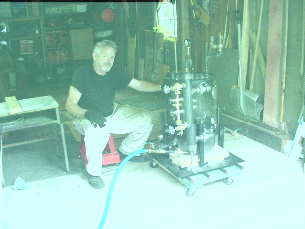

The VFT in the Margaret S. (20 square feet heat transfer surface) was put together by Columbia Boiler in Pottstown PA, and they welded the boiler together, did the paperwork and put an ASME stamp on it for $900 in 2010. I had to do the ASME Code design, procure all the Code Specified materials (about $1500), get all the material certifications, do all the metal cutting and preparation for fabrication by the ASME Code manufacturer. The labor I had to put in would amount to several thousand dollars at nominal mechanic's wages, but for me this was somewhat a labor of love, I just like to make things in metal. The ASME code rules have evolved over many years, and it is a good idea to use this knowledge if possible.
The scale live steam locomotive community also has several boiler manufacturers (non-ASME Code) that might provide your boiler at a lower price, but you should be cautious about the design and fabrication. The hobby rail live steam websights will provide guidence here. I have seen several of them where the manufacturer claims that the design would meet ASME, but I clearly see violations of the ASME Code rules all over the place. However many hobby locomotive boilers are well made and function reliably. Others are frightful amature work.
- WARMING BOILER.jpg (99.77 KiB) Viewed 6318 times
