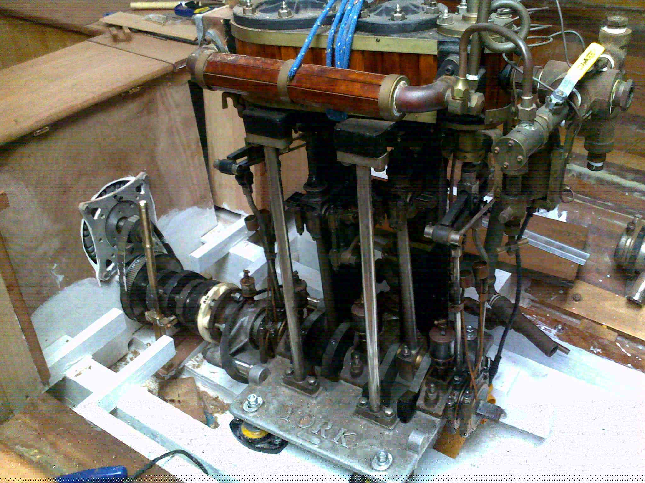

Re: CLUTCH
My boat is hybrid (An electric motor is hidden in the seat) I therefore need a clutch. Modes of operation are Steam, Electric and Steam charging batteries.
Photo enclosed
Photo enclosed
- Clutch.jpg (244.18 KiB) Viewed 16222 times

Re: CLUTCH
Is the rope there to keep that beast of an engine from jumping out of the boat?

Re: CLUTCH
Fred,
I'm using an XL X .375 timing belt to turn a small Motor/generator and when it isn't charging there doesn't seem to be any power lost at all. Now if the battery is low and I flip the charge switch, can definitely hear the engine drop down a note. The motor I'm using which is a 60 volt DC servo motor, had bronze bushings in it and I pulled it apart and re-machined the endplates and put sealed ball bearings in it. Turns very smooth with little resistance.
Preaton, the clutch looks like it will do that job. Beautiful York Compound too!
