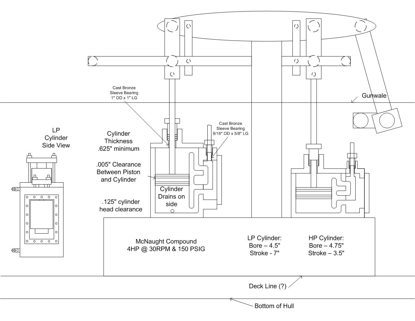

Here is what I have for the engine.
(Boy, I need to work on Visio. I was spoiled by four years of Revit and Solidworks)
I have decided to stay with slip eccentric for now.

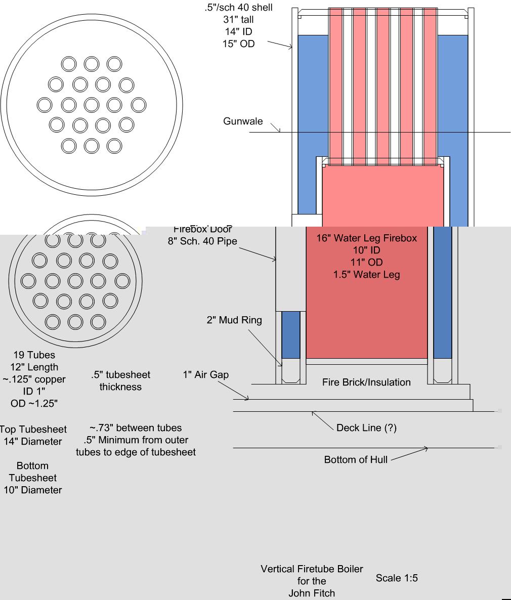

And here is the preliminary for the boiler.
I will add more details about mounting, insulation, fittings, and hand-holes later.

Re: Engine for the John Fitch
As a side note, I intend to comply fully with ASME codes wherever applicable on this project.
As I get closer to actual construction, I will re-visit all drawings while referencing every code I can get my hands on and make adjustments accordingly.
In the meantime, I have rounded up all calculations and will note any omissions of which I am aware.

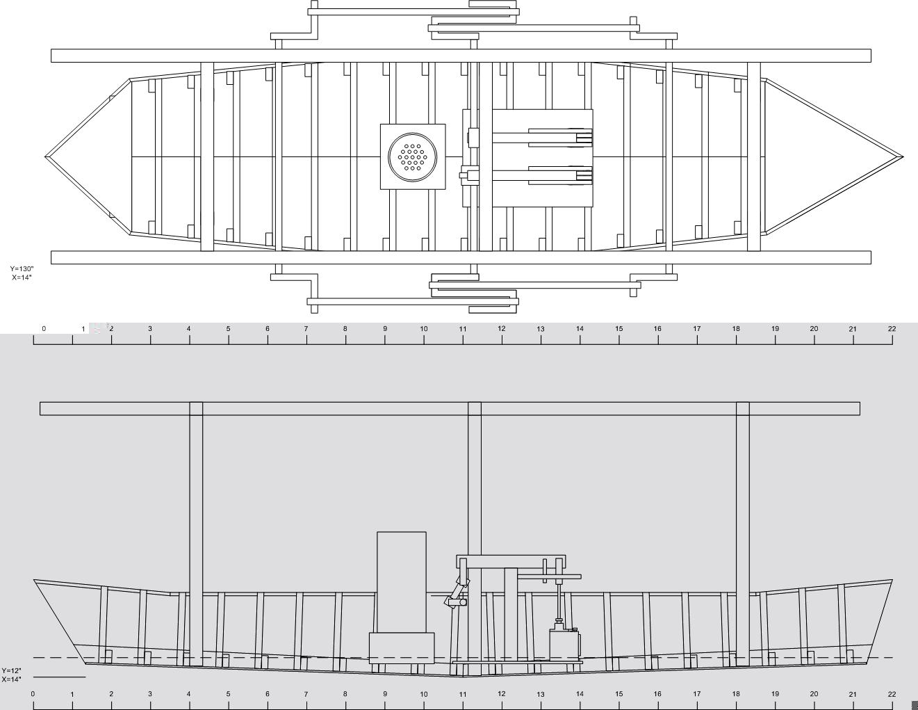

I laid out the engine, boiler, and beginnings of the superstructure in Visio.
The boiler seemed a bit small compared to the boat, yet my calculations show it should be good for just over 150% engine capacity.
30 + 30(5HP) = 180. 50% oversize for possible inefficiency/I'd rather build it too big: 270 PPH steam.
Firetube boiler at 3PPH/Sq. Ft., for 270 PPH = 90 Sq. Ft. heating surface.
My design has 98.8 Sq. Ft. (after subtracting the door area), around 10% larger than calculations call for.
I will compare the ratio to that of other boats as a sanity check.

Additionally, upon further review of the boiler design, I decided I wanted more steam room, and so modified the boiler by adding 3" to the outer shell around the upper tube sheet. I believe this would make the boiler of the "submerged tube" design.
- Boiler.jpg (101.37 KiB) Viewed 12916 times

Revised boat layout to reflect the new boiler.
- Boat.jpg (121.08 KiB) Viewed 12883 times

After attending the Great Delta Steamboat Meet, and reading Audel's Engineers and Mechanics Guide, I am re-designing the boat along what I hope are more realistic lines.
As part of that, I have decided to try for a McNaught compound instead of two separate engines, and reduced the horsepower to 4 HP accordingly. The compound means almost halving the required number of parts, mostly the larger parts (beam, frame, etc.). The design was based on all the material I could find on the Internet about McNaught compounds; the actual calculations for bore, stroke, and other specific dimensions were based off equations in the aforementioned Guide.
There are always more details to work out, but this is at least much closer to being practical than my original design.
