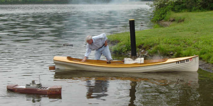

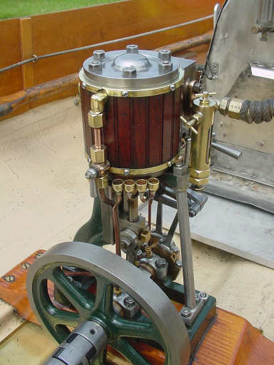

Have a look at the forum topic "Stuart No. 1 Posted: 07 Sep 2012 ", and see how this smaller engine does well with a 12 ft boat. Or search the forum for "wineglass".
- Livingston's No1, keeps up with all the steamers in our group.
- 12ft%20Stuart%20No1.jpg (30.29 KiB) Viewed 18904 times
- 12ftWherry.jpg (36.15 KiB) Viewed 18904 times
