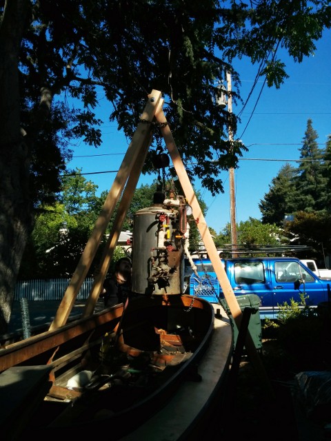

Otter has an oil burner, and the firebox has been .022 321 stainless sheet bent into a circle for the last 15 years, surrounded by Fiberfrax... well, a couple of years ago the stainless started to warp and twist, and it's gotten bad enough to seriously interfere with combustion. I hauled the boiler out of the boat, and am now almost done stripping the boiler and removing the pressure vessel so I can get at the firebox underneath.
I've decided to replace the Fiberfrax (wearing a respirator, natch) that formed the firebox insulation, and apply a couple of coats of refractory slurry made from 'Satanite', an AP Green refractory. This should give me a lightweight firebox (important to reduce heat up time and stop safety blowing after arriving in port) while protecting the Fiberfrax from contact with the oil flame. The 'Satanite' is good for 3200 F - rather more than the Fiberfrax - so it should make a good hot-face coating. I'll take pictures and report the results. This sort of setup has been used for propane fired forges and oil fired casting furnaces - we'll see how it works here. There's a lid on the firebox with a large center hole that is used to retain the flame in the firebox until it has finished combustion; this will now be made of Fiberfrax, well coated with 'Satanite', rather than formed out of stainless. I hope this will reduce the soot formation.

- tripod and chain hoist removing boiler

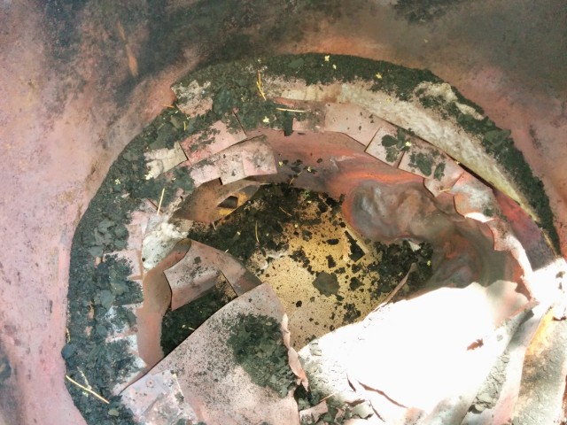

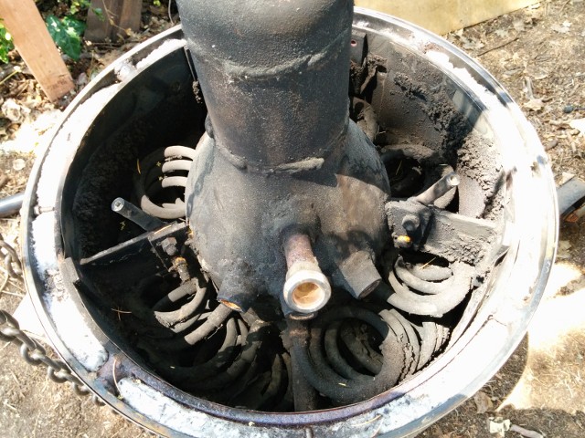

Some photos of progress:
- Firebox with old stainless liner.
- IMG_20140606_121117.jpg (106.88 KiB) Viewed 9927 times
- pressure vessel lifted out of the casing; there's a lot of soot.
- IMG_20140606_120509.jpg (96.37 KiB) Viewed 9927 times
- top off boiler, looking at pressure vessel
- IMG_20140606_115509.jpg (127.54 KiB) Viewed 9927 times

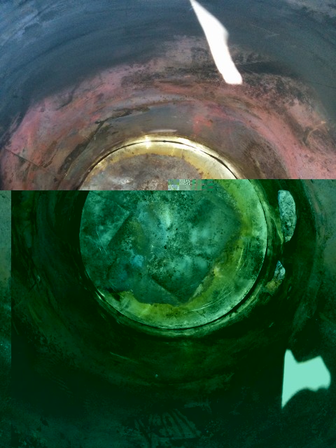

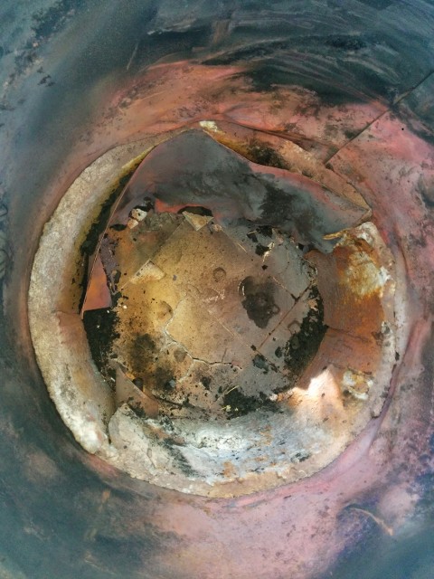

More photos:
- bottom of boiler casing; there's still 1" of kaowool behind sheet stainless here.
- IMG_20140606_155444.jpg (83.5 KiB) Viewed 9927 times

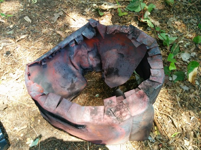

- kaowool liner, stainless doubler. All warped to h*ll and gone.
- IMG_20140606_124813.jpg (97.89 KiB) Viewed 9927 times
- stainless liner removed from firebox.
- IMG_20140606_124642.jpg (145.3 KiB) Viewed 9927 times

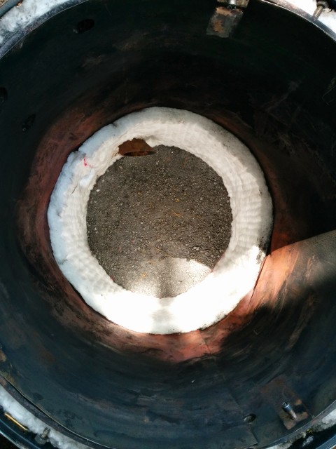

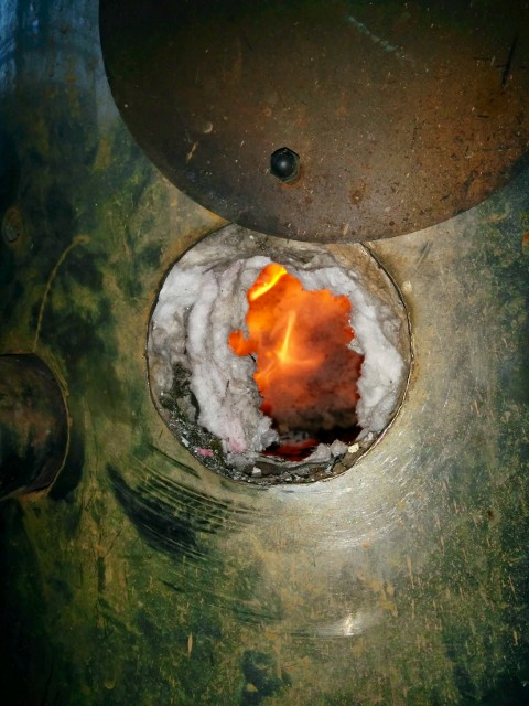

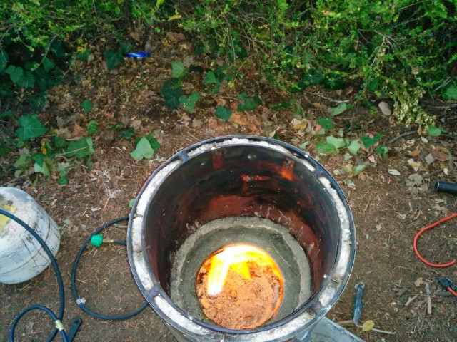

last pics. I used the propane feed through the oil burner's steamport (as I do when warming up) to start heating the Mizzou lining.
The lining came out pretty well, despite some problems being off center. There's some scantily covered areas right around the lighting and burner access ports; I'm going to lean the casing over and cover the patchy areas with more Mizzou like I did for the floor without a form.
The Mizzou seems quite strong. I'll try an oil fire (atomized with propane) later on in the week.
- kaowool before placing forms with bottom layer of hardened Mizzou in place.
- IMG_20140608_115259.jpg (73.34 KiB) Viewed 9927 times
- fire burning out wood + Formica used for forms.
- IMG_20140611_202509.jpg (137.59 KiB) Viewed 9927 times
- fire seen through lighting hole...
- IMG_20140611_202536.jpg (92.9 KiB) Viewed 9927 times

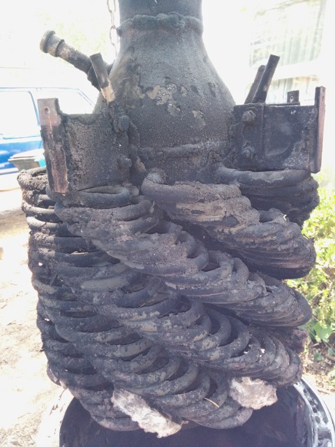

You must run with a really intense fire to distort the stainless steel so much. I used a large stainless steel cooking pot in the base of my boiler, it often ran red hot, but didn't get quite as "burned up", and basically kept its shape. With the boiler tubes sooted up in your picture, how much was the steaming rate hindered?
- Fp 2s.jpg (21.76 KiB) Viewed 9914 times
Re: New firebox liner for Otter
The fire is pretty intense (forced draft, oil + steam atomizing) and impinged directly onto the stainless, which was backed by kaowool. This meant that there really isn't a lot of cooling, and the stainless ran bright red/yellow much of the time in the center section. The stainless was in the boiler since about 1998 or so; I originally fitting lightweight firebrick but it cracked, as much, I think, from the trailering up and down I5 as from the fire. I continued to use the firebrick base, which worked well since cracking didn't matter much there so long as the pieces remained in place.fredrosse wrote:You must run with a really intense fire to distort the stainless steel so much. I used a large stainless steel cooking pot in the base of my boiler, it often ran red hot, but didn't get quite as "burned up", and basically kept its shape. With the boiler tubes sooted up in your picture, how much was the steaming rate hindered?
The steaming rate has varied over time. The boiler definitely has a harder time producing steam when it's sooted up as shown here; however, the soot seemed to stick in the less turbulent places and flake off other places. I am making a steam lance to make it easier to clean the tubes some, but as you can tell from the pictures the boiler coils form quite a nest. If I force the draft heavily that seems to help matters for a while; the new firebox should help here by retaining the flame longer in the combustion area. This may be helped by a mistake I made; the forms shifted somewhat during casting and the center hole in the refractory through which the flames are to emerge against the coils (around the bottom of the boiler drum) is shifted towards the front of the boiler. This may help increase the combustion time as well.

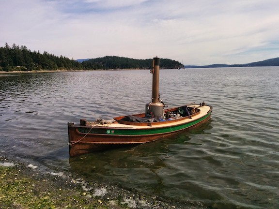

I never had time to properly shakedown Otter's new firebox other than limited tests in the driveway to find any plumbing issues, but she performed flawlessly nonetheless last weekend during our steam out and back to McConnell Island in the San Juan Islands. I can recommend Mizzou refractory for this purpose - it is heavy and retains heat, but it's sturdy and seems to work quite well.
- Otter ready to steam to McConnell Island with extra water (completely unneeded, we used about 1 gallon/hr of water and 1.25 gallon/hour of diesel), food, and misc. other supplies for a weekend of (damp) camping.
