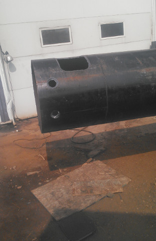

My new boiler being born...
She looks hungry for wood or coal already. :)
More details, drawings, and pictures will be disclosed as she develops. :D
Lower shell
Lower shell
