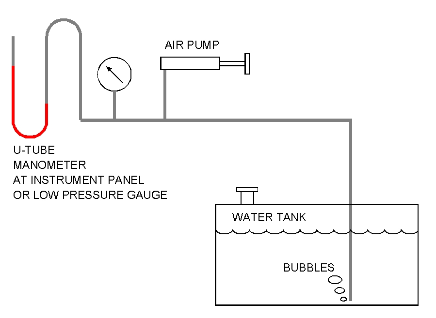

Re: Feedwater Level indicators
This level indication requires no electricity, and has been used for well over 100 years for remote tank level indication. The attached diagram is applicable to an atmospheric vented tank, and a similar arrangement can also be used for a pressurized tank, more on that later.
The pump is a small air pump, a bicycle pump is OK, or the very low volume discharge from any air pressure source at a few PSI. When to pump puts air into the system, a pressure buildup is needed to overcome the static water pressure at the discharge of the tubing inside the tank. This pressure is proportional to the level in the tank, and can be indicated by a manometer or pressure gauge at the instrument panel.
For example, say the tank level is 27 inches of water above the open end of the sensing tube inside the tank. A stroke of the air pump forces air thru the open end inside the tank, and creates an air pressure throughout all of the tubing corresponding to 27 inches water column. If the manometer is filled with water, then the differential shown on the manometer will be the same, 27 inches, and this is the indicated tank water level. If the manometer is filled with Mercury (specific gravity 13.6), then the manometer will register 27/13.6 = 2 inches of Mercury. A scale on the manometer can be made appropriate to the fluid used in the manometer. A dedicated pressure gauge might also be used as long as its pressure range is appropriate to the pressures involved, with a dedicated face scale as required.
- LEVEL INDICATOR.jpg (80.87 KiB) Viewed 11046 times
As always, you guys are amazing! Such wealth of knowledge shared here. I have spent two full days running around town asking anyone in town that I thought had experience with water tanks or water well systems and would have heard of this device - non of them did. It was suggested that I wait till one of the more experienced RV guys gets back from vacation to see if something in the RV industry would work. After these postings, I will probably rehab the existing system, at least with new tubing. The old tubing cracked, plus it seems really small. All the old brochures said to use 1/8" tubing, plus the gauge & air pump both have 1/8" nipples. There seems to have been 1/16" tubing used. The probe has a VERY small nipple, but the air pump and the gauge both had the 1/16" tubing "jammed" on the 1/8" nipples. I'd like to see if I can find a fitting with the 1/8" nipple to install on the probe - get it all standardized.
As regards the standard "universal" Sending Unit from Westmarine. I already installed a similar universal unit purchased at NAPA Auto Parts on my fuel oil tank, which wasn't working either - once connected, worked correctly straight away (love it when that happens). The Auto Parts dealer made some calls and I was advised a fuel system sending unit would NOT work in a water oriented tank application.
Thanks again guys for all the input, data, links and drawings to help me work things out. I am very grateful!!!
