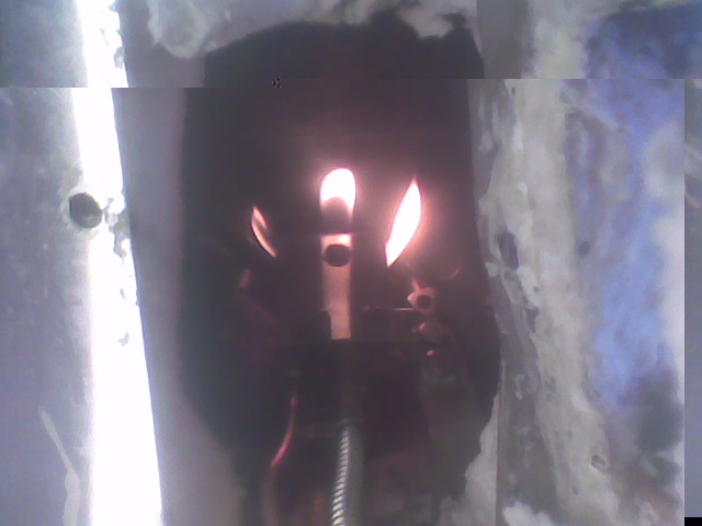

The boiler has been fired twice, each time with some propane burner difficulties.

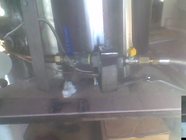

The burner system was purchased from a commercial gas supplier and it consists of a pressure reducer/regulator, isolating cock, safety valve, pilot burner with flame detector loss shut-down and a ball-valve gas regulator.
The kit is the same as that provided for use with wok cookers in asian restaurants.
The difficulties experienced centre on draft control.
The pilot cannot be reliably lit with the natural ambient temperature draft up the stack, a damper fixes that.
When the main burners ignite, the pilot is extinguished and, a few moments later, the system initiates a safety shut-down.

Sounds as though it needs a guard around the pilot to keep the flame on the thermocouple while the main burner is on. Some guarding or repositioning the pilot should fix that. Position the pilot so it's flame and thermocouple parallel the direction of the draft. If it's 90 degrees to it, the increased draft will pull it away. And consider using a larger orifice on the pilot for a larger flame.
Re: Propane Burner Arrangement
Ron has the right answers here, and try to use stainless steel for the shroud around the pilot, it will hast a long time. On cooking equipment the pilot is made as small as possible, to reduce standby losses when the burner might not be used for days or weeks. For a launch boiler, a pilot can be 100x this size, so it keeps steam up to a minimum, in addition to providing the same safety features. Hopefully the intensity of the pilot can be adjusted.

Some poor photos showing the latest build status.
The builder drilled the pilot valve out to 1 mm (thought to be about 0.3 mm before) and got a very large pilot as a result.
A pilot shield was added to direct one of the three pilot flames onto the temperature detector.
An adjustment on the safety valve reduced the pilot flame down to something manageable, and photo #37 shows the pilot in the burner chamber without any damper on the stack.
Photo #38 shows the main burners operating without any damper on the stack.
The pilot is dancing around due to the air turbulence, but not going out.
Photo #42 shows the gas safety valve.
