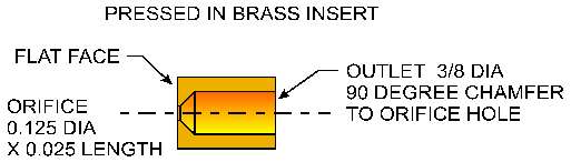

Just added "Testing Boiler Output" to the FAQ section of the forum. Rather long winded and boring, but it will give reasonable results.
Attached drawings of a typical test orifice for small launch boilers, made by pressing a brass insert into a small pipe nipple. Orifice size should ideally be reamed, and it is important to NOT break or chamfer the sharp inlet edge in any way. This orifice will have a discharge coefficient close to 0.6
The 1/8 inch diameter orifice shown here would pass 43 Pounds per Hour (PPH) steam flow with 100 PSIG inlet pressure (114.7 PSIA)
If all the orifice dimensions were doubled (to 1/4 inch diameter orifice), then it would pass 4x as much, or 172 PPH @ 100 PSIG.
- ORIFICE NIPPLE.jpg (13.67 KiB) Viewed 21227 times
- ORIFICE INSERT.jpg (13.89 KiB) Viewed 21227 times

Hey guys
Thank you for the information and the pictures Fred.
That seems pretty straight forward. So we start with a coil in an insulated enclosure. The enclosure sits atop a Kast-O-Lite 30 fire box with burner assembly that can be changed out easily between test runs.
The input of the coil will get a temperature sensor, strainer and some form of flow sensor. The strainer at this point is to keep the flow sensor functioning during tests. After the tests it would not be needed in the system.
The output of the coil will have another temperature sensor and a strainer? I know there should be a strainer at some point before the pump but placing it at the pump intake will restrict flow and may cause cavitation. Any thoughts?
The output of the coil is fed tangentially into the separator. The steam safety valve, steam shut off valve, running steam gauge, drain valve, feed water input from pre-heater and so forth are plumbed into the separator.
Heated water swirls around the inside of the separator, enhancing steam separation. The pump intake port at the bottom of the separator is arranged so that the swirling water enters straight on.
A fixture is made with a shut off valve, temperature sensor, pressure sensor, orifice bypass valve, orifice, then vent to atmosphere/water tank. Can I do the water tank temperature rise test at the same time?
Then it is just a matter of making a lot of steam and keeping track of time and numbers.
Does that sound about right?
