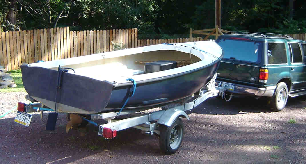

Two Canoes, I think too complicated. Why not just buy a 16 to 20 foot long fiberglass hull for a few hundred bucks and build a steamer on that framework. Much less work for you, and much more seaworthy.
Good fiberglass Sailboat hulls (with bad sails or a broken mast) go for very little money, often with a trailer too. Fiberglassing in a propeller shaft tube, (after cutting out the centerboard well) takes about 10 hours work only. Then you get a well streamlined, seaworthy hull with little money and effort spent.
- ODay Javelin, $107 with Trailer, Converted to Electric, 14 x 17 Prop
