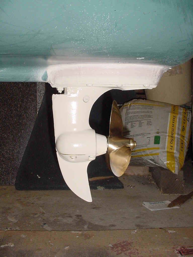

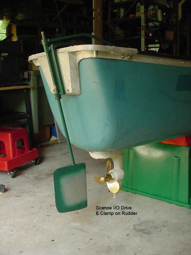

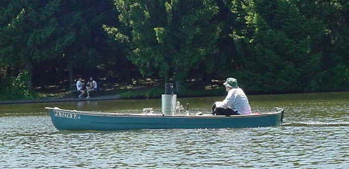

15 FT Coleman Square Stern Canoe (Scanoe) with Flash Boiler and 4.7 cubic inch chain saw engine converted to steam. I/O drive, made from a 2.5 HP outboard lower unit, turns a 7" x 7" propeller at 700 RPM, 4 MPH. One of the very few "Car Top Carry" Steamboats.
Stern View
Stern View
I/O Unit, bolted thru Plastic Hull
I/O Drive and Clamp-On Rudder

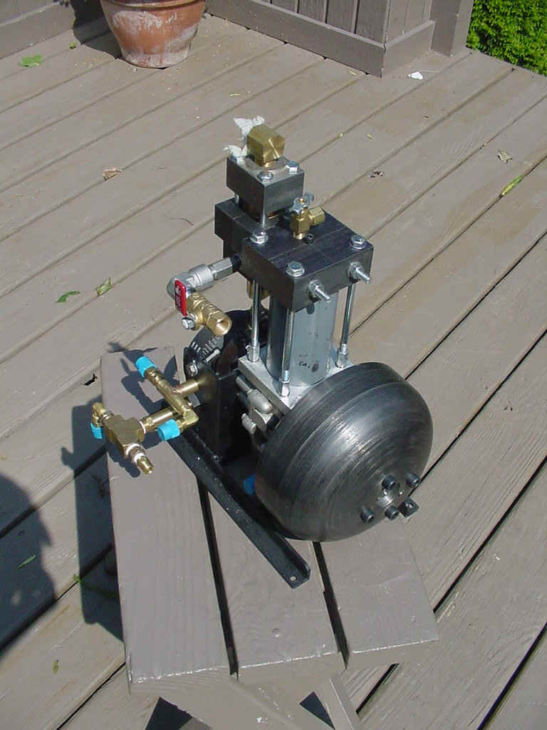

Scanoe Power Plant.

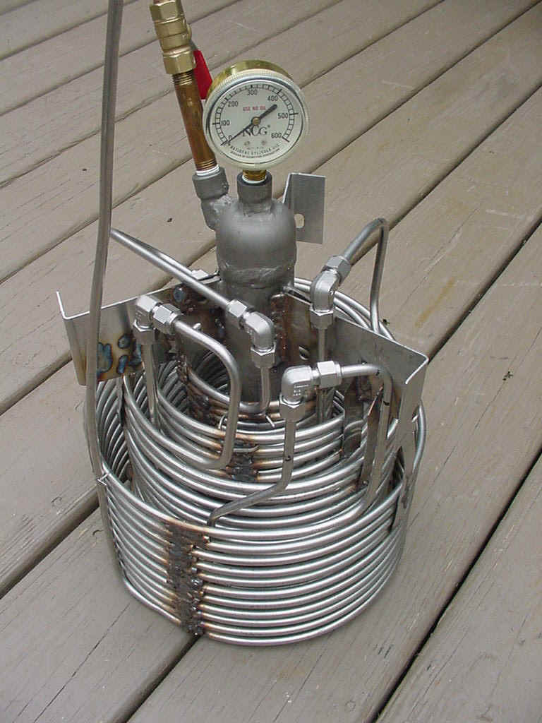

Flash Boiler Coil, 1/4 inch OD tubing. Generates saturated steam, 150 PSI
2 Stroke engine conversion, cylinder from a Pneumatic Cylinder

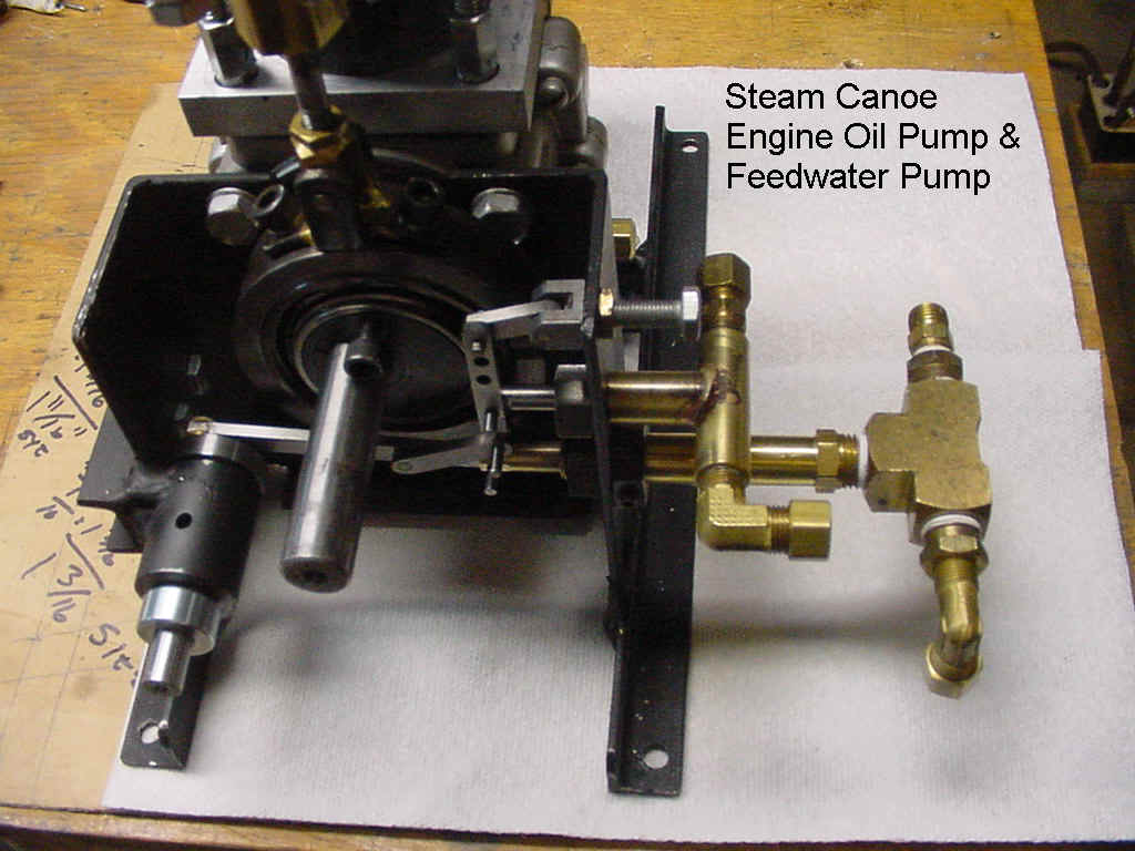

Oil and Boiler Feedwater Pumps, run at reduced speed

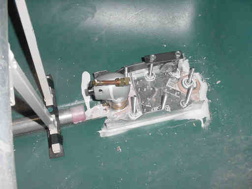

A few details of the Steam Scanoe Drive system.
The drive system consists a timing belt drive (2:1 Ratio) from the steam engine (600 RPM) to the main horizontal drive shaft (1200 RPM), then an ordinary $20 hardware store right angle drive (1:1 Ratio) to get the output on a vertical shaft (1200 RPM) inside the boat. The vertical shaft (1200 RPM) connects to the Outboard Lower Unit, which has its own gear reduction, 1.7:1, so the propeller output shaft runs at 1200/1.7 = 700 RPM. The "step-up" gearing to the horizontal inboard shaft is required as virtually all small outboard lower units are designed with gear reduction, so the propeller turns at a very much lower speed than the IC engine which originally powered the outboard.
The $20 hardware store right angle drive (1:1 Ratio) is usually used to allow a portable electric drill to be used in conditions where clearances are too tight for use without one.
The attached picture shows this right angle drive as fitted within the Steam Scanoe, located just above the outboard lower unit. This gearbox is good for about 1/4 horsepower, which is the approximate power of the Steam Scanoe. I also added a lubrication tube to assure oil in this gearbox.
