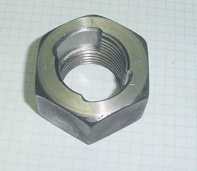

Many Steamboats carry a muzzle loading cannon, but as I recall the steam age brought breech loaders firing fixed ammunition to the sea, so I am in the process of modernizing.
Got a 12 Gauge rifled barrel on e-bay, and started machining the receiver today from a 1-1/2-8 nut. The deck gun will fire ordinary or 3 inch magnum 12 gauge shells, and will be using the classic interrupted screw breech mechanism. Another wintertime project.
Deck Gun

This breech mechanism will be plenty strong for the pressures produced by any standard shotshell loads. SAAMI standards indicate 11,500 PSI Maximum Shotshell Pressure for 3 inch Magnum Slugs, with Proof Loads of 19,000 PSI. The most highly stressed part of the mechanism is the breech threads. Calculating with a 20,000 PSI Proof load, the shear stress in the breech threads is only 13,300 PSI, not much even for mild steel.
