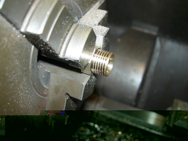

Re: An Odd Thread
They say that cats have nine lives, there is also more than one way to get their fur off!
Turned the thread down to a thou or six less than 9/16",
DSCN5752 (600 x 450).jpg (47.86 KiB) Viewed 6374 times

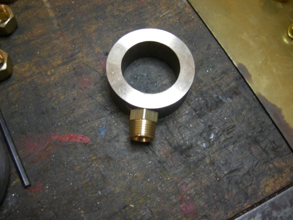

Just got to silver solder it in place now!
DSCN5753 (600 x 450).jpg (60.33 KiB) Viewed 6374 times
