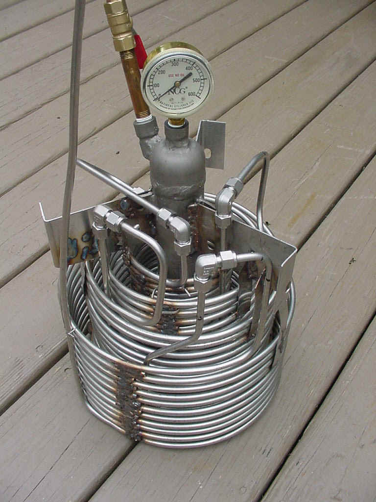

The boiler we're not too sure about - Fred used a monotube made from 304SS and Swage-Lok fittings, and we will probably go a similar route if I can get an idea of how much steam we need, and how much tubing that will require. If that doesn't work out, the next option is to simply buy a boiler from Beckmann, as we have neither the equipment nor the skill to safely build/weld a more traditional boiler ourselves. We have a casting kit for a hand feed pump from Pearl Engine Company; I will take a look at that after we get the engine going, to see if we can't machine it ourselves.

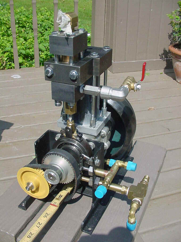

With a monotube boiler you will need an engine driven feed pump (in addition to the manual feed pump) because the monotube boiler needs continuous feed. Fuel feed should also be continuous, so I used propane. For the canoe, 5 to 10 square feet heat transfer surface area (HTSA) is required, based on the surface exposed to hot flue gasses.
My scanoe boiler had 5 square feet HTSA, and the center steam/water separator was made from 1-1/2 inch schedule 40 pipe. The arrangement was designed to keep all of the steam generating coils wet (steam and liquid water two phase flow) which avoids possible overheating. 100 MPH Steam hydroplanes with high superheat coils can perform much better, getting several horsepower from a boiler much smaller than mine, but with shorter life and much more excitement. The steam hydroplanes virtually all use gasoline vaporizing burners, which are noisy.
Conversion of an outboard to steam is not too complicated, and bash valve arrangement will work for several engines. The devil will be in the details here. There have been some other successful steam outboards made, correspond with the Northwest Steam Society for further details. From what I have seen, the original outboard vertical shaft, (and crankshaft I think) has been retained, with steam cylinder added.
Scanoe Engine, Plastic Timing Pulley Drives Pumps
Monotube Boiler, 5 sq ft HTSA, 1/4 OD Tubing
