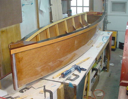

Re: Building a small flat bottomed boat
You may want to look at the quick build of a small (11 feet long) plywood boat that is a replica of the larger sidewheeler hull, but scaled down, and built with common 1/4 inch thick "Laun" plywood, fiberglassed over. It is made with light weight frames and chine construction, in my view more rugged than stitch & glue, and fairly easy to produce. Look in the old thread on this forum, "New Plywood Sidewheeler Building".
That small boat is car-top carried often, but is relatively heavy at 39 kg (86 pounds). That is because I used heavy fiberglass and epoxy, left over from building the big steamer, and have a heavy flooring, which could have been far less weight. I am planning a portable "drop-in" steam plant with side paddlewheels, that will result in no new holes in the hull, and still allow use as a canoe for those with strong rowing arms. The "drop-in" steam plant concept allows car-topping and setup without the use of a forklift!
