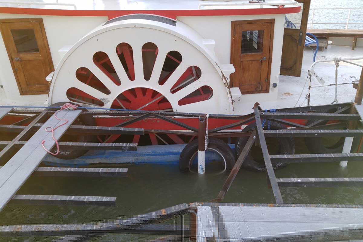

- The dented toe rail and another missing section of dock framing.

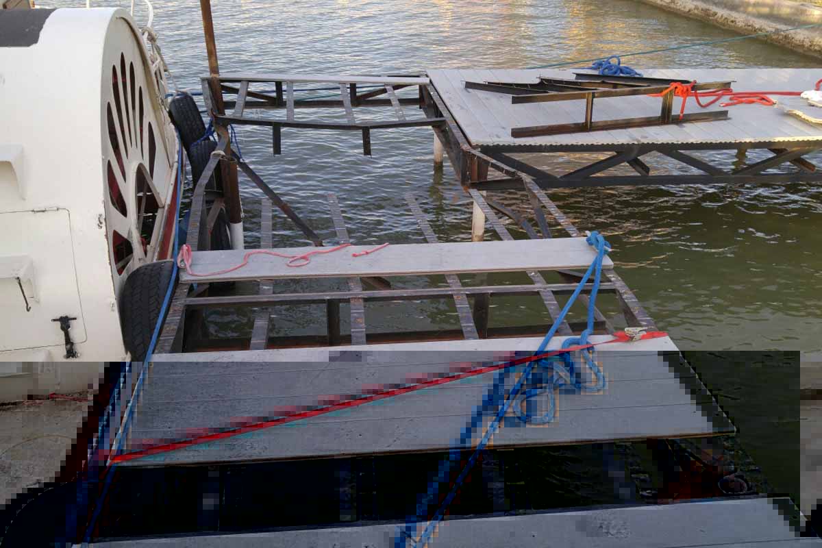

- All the fractured and damaged decking boards removed to show the extent of frame torquing and busted welds from February 1st Storm.

- The dock you have in the pictures is set up to resist vertical compressive loads, but offers very little side impact resistance.
A dock should be strong enough to hold passengers and cargo weight, but also sustain an un-powered half-speed impact without significant damage or causing danger to embarking/disembarking passengers. Which leads me to...
-... a dock built of timber is highly recommeded; it is simple to install on thick piles, set at around 6-8ft centres depending on diameter. This allows you to put both longitudinal ties between all the piles, but also 'x' ties between piles in the opposing direction to an impact. A timber dock on vertical piles is also slightly flexible- make the 'x' ties in plan view, not section view, and the impact is spread through the entire length of the pier rather than localised to the point of contact.
Timber is also far more sympathetic to timber parts of the boat and doesn't cause any damage to the steel extremities of the vessel.
Timber piers can also be repaired/modified easily, and allows easy tailoring of placing rubbing boards etc.
An 'L' shaped jetty can have vertical 'wash boards' on the inside and outside perimeters, which means that with a look at the weather forecast at the end of the day, the boat can always be placed in a relatively sheltered spot overnight. If this isn't possible then pile 3 or 6 substantial pile groups (a group of piles at 4ft centres on a triangle plan, with timber through-bolted ties is the best formation) around 30ft off the pier, parallel to it, and this will allow you to spring the vessel off the pier by 10-15ft, allowing her to ride out the storms without being in striking distance of any large static objects.
