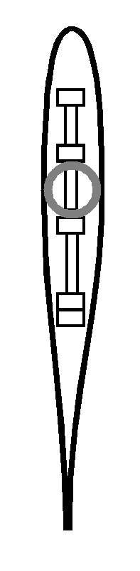

A fairly simple, and effective rudder can be made from a 18 x 24 inch piece of sheet metal. Make a 170 degree bend with generous radius on the upstream end of the rudder (18 inch direction, giving two sides, each 12 inches x 18 inches) pop rivet the trailing edge of the rudder with a sharp exit, like typical fish fin shape.
The rudder shaft is made from a piece of 1 inch pipe, as shown in the attached picture. Four long bolts, (6 inches long, spaced at 4 inch center to center) running fore and aft, extending a few inches forward and a few inches aft of the pipe, with nuts tightened onto the pipe, plus nuts tightened together at the ends of each bolt. These bolts transfer the torque of the rudder to the rudder shaft.
Slide the sheet metal rudder over the shaft, and Pop rivet the rudder to the pipe shaft. Then fill the voids with automotive body putty, (Bondo in the USA), or better yet, Bondo Hair (very strong). 30% of the rudder area forward of the shaft, 70% aft. Dress the Bondo edges, make it pretty, and paint the assembly.

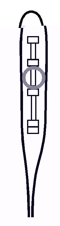

A better profile, still easy to make.

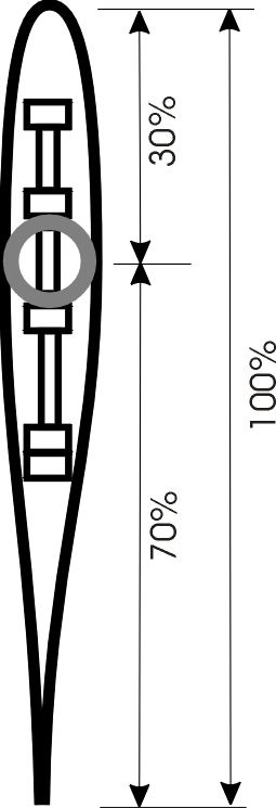

The 30% of rudder forward of the shaft is shown with the following drawing, hope you can understand this crude sketch.
