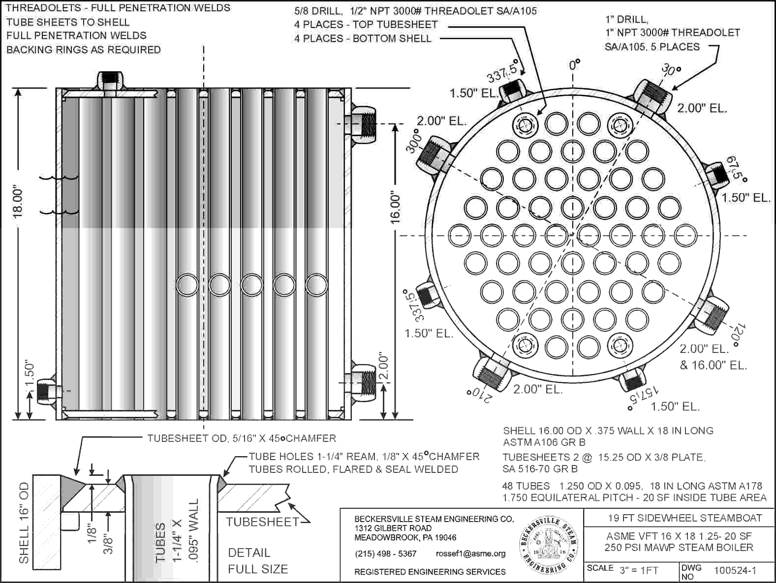

An attached boiler drawing, suitable for a small steamboat, with 16 inch diameter shell. Probably your 14 inch shell could be adapted, being about 12% smaller. What is the material of your shell, and actual dimensions, Outside Diameter, Wall Thickness, Length, and material specification (if available)?
- 16ASME-1Assss.JPG (98.13 KiB) Viewed 19096 times

Re: Durham Donkey Boiler
Nice drawing, Fred.
I would build it with a water leg. Except for the firebox penetration there are no drawbacks that come to mind and the steam producing area of the boiler are so much improved.
just two rings and the firebox hole and you easily double the area that receives radiant heat from the fire.

One often reads this argument in favour of water leg VFT boilers, however if it were true, i.e. the only radiant heat on a dry wall VFT is the tube base sheet, then they would hardly work at all. The fact is that besides Bill Duhram, Strath Steam sold dry wall VFTs for years and even Simpson Strickland made them in the early 20th century and I've not read of any complaints.Lopez Mike wrote:Nice drawing, Fred.
I think what happens in the dry wall boiler is that the casing becomes very hot and, as anyone who's held a piece of metal whilst the other end is heated will testify, the heat transfers upwards, thus to the boiler surround. A correct calculation as to the heating area should include the entire drum circumference, which would actually be greater than that of a water leg version.
Added to the much simpler construction of the dry wall and the well publicised problem of sediment accumulating in the legs of water walls, I think I'd prefer a dry leg.
It would be interesting to hear from anyone with experience of a dry wall VFT as to its characteristics.
