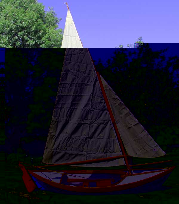

Stitch & glue construction, a canoe or two and the last vessel was a lovely little yacht (see attached photo).
I have now ordered a set of study plans for the project from Selway Fisher.
Ian
