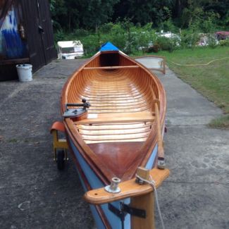

Hi,my name is Lucian and I need help about motor and boiler to make a kayak steam boat.
I will put pictures..and I have some questions.
I'm thinking to use air compressor engines to transform them to steam..but which one?
The main problem is the boiler...expensive,not so easy to find..but if you can tell me what specs must
have one..
Thank for any help.
Steam boat project
Steam boat project
- $_75 (2).JPG (22.64 KiB) Viewed 10386 times
- $_75 (4).JPG (27.06 KiB) Viewed 10386 times

Welcome Lucian. The information you require will no doubt be forthcoming, this is a very knowledgeable forum. Some further information on your hull might help a little, such as how long. Driving a canoe hull is easier than some other hull forms.

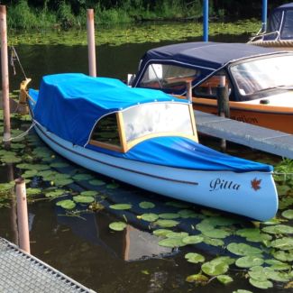

Hi,it's not mine yet but I like it very much and I want to buy it.Even if I want so much to have it with steam this year will not be possible I think..but I want this summer to go all Danube from Germany to Black Sea in Romania, my country..about 2600 km..thinking to use outboard 3 HP engine...and to make steam boat to enjoy for lakes and rivers ..
I like this one cause it looks like old boats and the cover for raining it's very for this long trip.

The canoe you are thinking of purchasing is indeed very nice! I would guess a 3 HP outboard would be much more power than you would need, about 1/4 HP would be OK.
