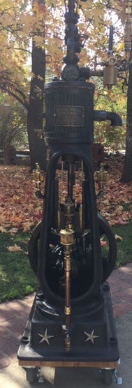

Greetings all. I recently picked up a St. Louis Steam Engine, circa 1898! It's still fully operational to my delight.
I've not calced out the HP as of yet, only has a 4" bore and 4" stroke. I would like to locate a vertical boiler that's a bit on the vintage side but still operational. Prefer wood or coal fires, conversion to LP would be okay.
If anyone knows of one, I'd deeply appreciate a holler. Located in N CA, the Sacramento Area.
Thank you.
Thank you.

Welcome to the forum Jim,
That's a nice engine you've got there!
On my travels with Cal Fire I've seen a few single-lap riveted VFT's in the foothills around Jackson, etc. Usually they're yard art. Probably would have to be re-tubed at a minimum, if they can be safely revived at all. Next time I see one, I'll try to get their contact info.
~Wes
~Wes

Welcome to the forum from me too Jim, and it is indeed a pretty looking engine you have there.
Do you want the engine to do serious work, or just get it to turn over under steam? It makes quite a difference, because by steam launch standards 4" x 4" is a medium rather than small engine, and it will need quite a lot of steam to run it properly. I would suggest something with only maybe 10 square feet of heating area, with 1 or 2 square feet of grate, would be enough just for a demonstrator, but 60 square feet might be more like it for serious work (less if you employ forced draught).
Either way, as said above, any elderly boiler will almost certainly need re-tubing, which if you're lucky is quick and easy, but in general is quite a demanding (and expensive) exercise. I would also be extremely dubious about a boiler shell more than 2 or 3 decades old, and with unknown pedigree - though you might be lucky. A new-built boiler could well be a better bet. The good news here is that many of the available designs resemble closely those from 100 years ago, and certainly wouldn't look out-of-place with your engine.
I'm in the UK, and so can't help with recommended small boiler makers in your area, but I expect someone else can.

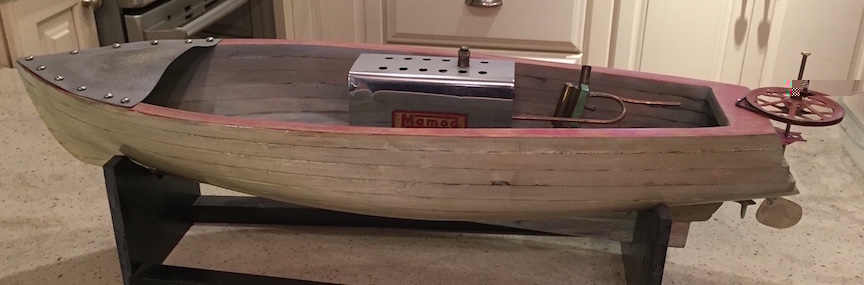

Lets have a bit of fun, I must set the record straight, I do have a steam boat.
Only difference is mines in inches, not feet!
