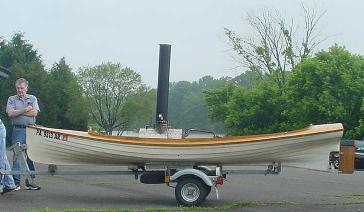

- Muskrat on trailer. Livingston hand made the propeller for this steamer.
- 12ft WherryTrailer.jpg (40.64 KiB) Viewed 14544 times

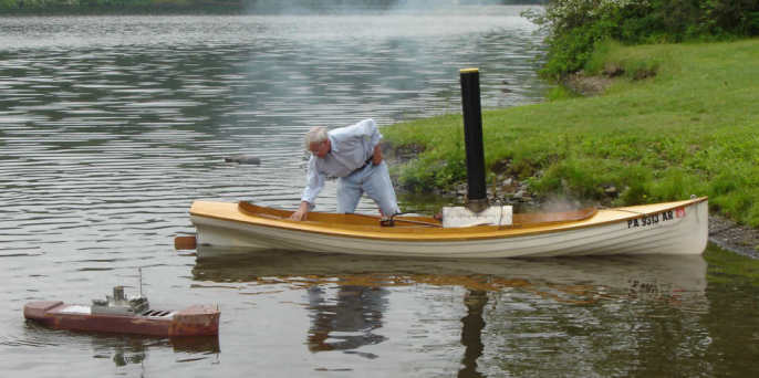

- Livingston getting Muskrat ready for an outing
- 12ft Wherry.jpg (36.15 KiB) Viewed 14544 times

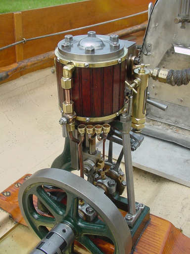

- Note the lubrication cups with tubes to the bearings.
- 12ft Stuart No1.jpg (30.29 KiB) Viewed 14544 times
