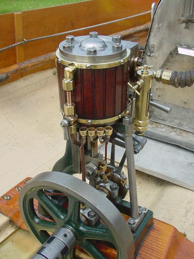

How many oil cup lubricator are there in a full set?

How many oil cup lubricator are there in a full set? ANS: See attached picture of a Stuart No 1 in a small steamboat, a good example of a reliable engine setup.

- Lubrication cups and displacement lubricator on Stuart No 1 steamboat engine.
- 12ft Stuart No1.jpg (30.29 KiB) Viewed 6553 times
