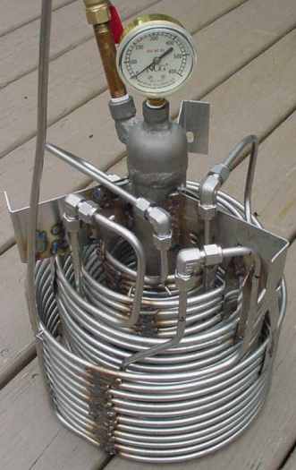

My 2 cents worth, use compression fittings with 2-piece furrells, the best is Swagelok brand, but Parker and others make similar compression fittings. These are reliable to several thousand psi, and can be taken apart several times with never a leak. The down side is that they are expensive. I agree that the single furrell compression fittings found at Home Depot are not for high pressure/steam service.
Swagelok makes them in stainless steel as well as brass, and carbon steel. I have used them within the furnace of boilers in both stainless and carbon steel with never a leak, however I would not recommend the brass ones in a furnace environment. For a copper economizer coil, where gas temperatures are down below 1000F, the brass Swagelok fittings will do well so long as the economizer is kept flooded with water. The ASME Boiler code does allow copper alloy piping and fittings in service to 406F maximum, corresponding to 250 psi saturated steam pressure.
A pic of a coil boiler I made with Swagelok fittings, stainless steel, 5000 psi test, 200 psi operating pressure.
- Sca-boilcoil.jpg (20.14 KiB) Viewed 20903 times
Re: "Union" fittings
I don't have any problem with using S.S. tubing and Swagelock fittings but they ares a little thin on the ground at the corner hardware store where most of us steamers get our piping.
Your stuff looks like NASA construction. Mine runs more to a hillbilly still.
