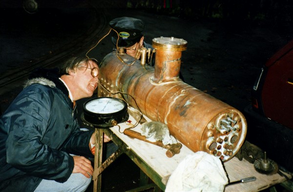

75 The Boiler Inspector Seems Pleased (600 x 393).jpg (61.79 KiB) Viewed 28046 times
I made this boiler with two large (Sievert) propane torches. It weighs in at about 1.25 cwt. The secret is to keep the bit you don't want to heat, covered, with either fire brick, or blanket, or both. Both torches are used to get the temp up, the solder feeder then concentrates on the joint while the mate keeps the surrounding area heated.
The biggest problem was differential contraction, so when the joint was finished the whole thing was covered and left. One time it was still warm to the touch 2 DAYS later.
Sorry about the quality of the pic, it's a scanned colour print.
