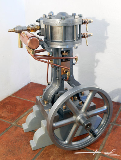

Newly build model of vertical double acting steam engine. Approx. 17" height with a 9.5" flywheel, weights 40lbs. Bore 2.85"(72.6mm), stroke 1.95"(50mm). Max 600rpm. Loose eccentric for easy reversing and low friction motion with securing brass nut. Unique copper "central" wick oiling system. Made by myself from the very beginning - design, calculations, patterns, dense aluminium and bronze castings. All working surfaces made from steel and bronze. Honed cast iron cylinder lining. Ground crankshaft. Ready-to-run on air for 2 - 6bars. It was supposed to be installed in a small launch. Built by me - Ms Daniela Filová - professional engineer and machinist. Located in the Czech Republic. I can ship worldwide.
I am trying to start up my own company so here is the link to my webpage that you can see other photographs and video of running engine.
http://www.danielasteam.com
I have one finished and tested. I am willing to make minor changes on request (eg. to swap the flywheel for the one without the spokes for safer use on boat...).
I have started preparing it to be run on steam (displacement oiler, steam regulating valve...) but honestly I spent more than 1 year on the whole project without any revenue so I do not want to put any other efforts if no one will be interested...
I hope you will like it. Also I presume it will not be considered as a real business ad as this is the very beginning of my new adventure with my "products".
It has almost 2x bigger cylinder volume than Stuart 5A! Despite the "subtle" appearance of the steam engine - I originally design it for operating pressure of 10bars - so when properly oiled and used at 6bars it should be a "long runner".
Nevertheless enjoy the images.
Please do not hesitate to send me the questions - I am open to discussion!
Daniela from Danielasteam

The Stuart 5a has 2 1/4" x 2", but your engine 3" x ~2", so your engine is twice bigger than the Stuart. If the engines are driven by 6 bar steam and 600 rpm your engine will need 1,12 kg steam/minute, the stuart only 0,62 kg/min (only calculations).
There is also a difference between your post (boring 76,2 mm/3") and your website (72,6 mm). Can you check it.
Best Dietrich
i think you are wrong.I think it can be good alternative to Stuart 5A!

Yes, I was wrong - you wrote it right Dietrich. I corrected it. My quick estimation was bad estimation
Also I do not want to write theoretical power output as this is very dependable on many factors. Possibly I will measure it in the future - I will build simple flywheel brake rig - still so many tasks to do...
Daniela
