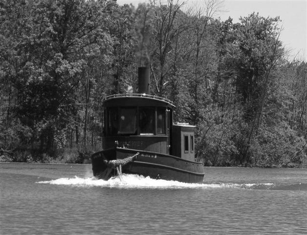

I've never had much trouble with creosote or soot in the flues.
Creosote or large amounts of it is from burning green wood or certain types of wood. Soot is a product of incomplete combustion.
One of the advantages of non-condensing systems is the ability to exhaust up the stack by inducing draft. Inducing draft greatly increases the amount of oxygen to the fire and provides a more complete combustion. Watch videos of my Tug, you'll see there is rarely any smoke coming from the stack. It also pulls fire in to the tubes and burns up most everything. When I clean the flues, there is only small amounts in a few areas (near the firedoor).
In the attached picture, you can see the amount of heat, and no smoke out of the stack. In a steam car, if we're making smoke other than first startup, we have an issue that needs to be corrected, otherwise the performance is greatly degraded. The same goes for burning any type of fuel.
The issue other than related lower performance is soot coating the insides of the heat exchanger. Soot is a very good insulator. I think I read something like 1" of soot is equal to 7" of ceramic insulation?? something on that order, but the point is, it's bad and should not be allowed to collect on heat exchanger components.
Run that exhaust up the stack, that's probably cheaper than building a steam lance. Ask your traction engine buddies how there engines would run without exhausting up the stack. That is one of their and Locomotive folks points of concentration for optimal performance, positioning and sizing of the nozzle on the exhaust outlet in the stack.

Ron,
I have this[Exhaust up the stack], I've only run it once on the water. I have a 10ft steam stainless braded hose 1" NPT. Yesterday I tried, to use it, but I failed to realize that a valve was shut off - so that choked the engine, and I just decided to vent of the side for the day instead of investigating. When we went out to dinner later I realized that there was a valve which was shut. I came back to the dock and it was shut.
There s an issue that if it is minimally wavey this hose will dip through the water which is not what I want it to do. I really don't have anything in the hull, as the hulls are the pontoons. So I need to insulate/waterproof it, or put it on the top of the deck.
It is on my laundry list.
I'm a total believer in "pufffing". I just want to be able to turn it off when I want.
