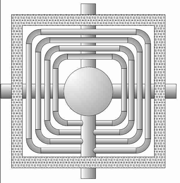

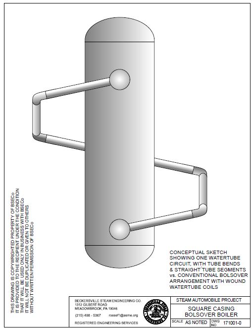

I have considered making a variation of the traditional Bolsover Boiler, which basically has a cylindrical outer casing. Same configuration as what you described, although using 90 degree bends to wrap around the center drum rather than a standard type coil. This would result in a boiler with a square outer casing.
The advantages here would be that a 90 degree bender only would be needed, possibly using the cheap hydraulic bending machines sold for around $100. Any reasonable pipe/tube bender could be used to do the job. This strikes me as far easier than winding a large pipe/tube coils.
The square outer casing would also be simplified, using the semi-rigid refractory board for the furnace/casing liner, then less expensive outer insulation (fiberglass board), then finally wood outer lagging.
The sketch shown is conceptual only, and would be modified according to the available bend radius of the bending machine. Note that the bends are close to 90 degree bends, but are actually less than a full 90 degree bend. The math to figure out the bends and the length of the straight segments is a little complicated for this old brain.

- Conceptual Modified Bolsover Elevation
- BolsoverElev.jpg (43.17 KiB) Viewed 13823 times
- Conceptual Modified Bolsover Plan
- Bolsover.jpg (38.86 KiB) Viewed 13842 times

Certainly could be easier (in some cases) to make, but the large unfilled spaces in the 'corners' of the central stack could waste a lot of heat. Could they not by filled with some Lifu tubes?fredrosse wrote:I have considered making a variation of the traditional Bolsover Boiler, which basically has a cylindrical outer casing. Same configuration as what you described, although using 90 degree bends to wrap around the center drum rather than a standard type coil. This would result in a boiler with a square outer casing.

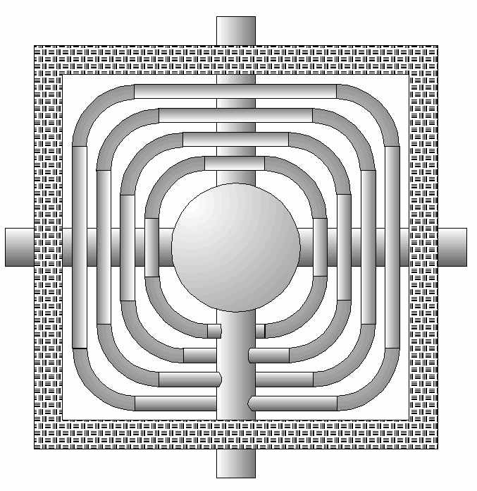

".....but the large unfilled spaces in the 'corners' of the central stack could waste a lot of heat. Could they not by filled with some Lifu tubes?"
Yes, that could be an option, although I had considered only some simple baffles within the boiler casing to stop the flow in the "short circuit" paths near the central drum and corners of the casing. The sketches I posted are conceptual only, and one could get around the disadvantage you mention by using a somewhat larger bend radius on the tubes, such that the unfilled spaces are minimized. Another sketch.
In developing a detailed design there are many more considerations, for example: Inner coils vs outer coils, maintaining sufficient slope, perhaps twice around on the inner coils vs the outer coils. Sizing the various components for adequate circulation, staggered left hand and right hand coils vs. all coils right hand (or left hand), adding slope to the four radial headers, arranging the burners to avoid heating the place where mud would accumulate, etc, etc... A virtual field day of design details to consider if one is to make an optimized design.

- Larger radius bends on Square Casing Bolsover
- BolsoverPlan2.jpg (71.07 KiB) Viewed 13821 times

fredrosse wrote:".....but the large unfilled spaces in the 'corners' of the central stack could waste a lot of heat. Could they not by filled with some Lifu tubes?"
If the radii increased the further out from the central drum then the spaces would be further reduced, but in the end you come back to the original coil which you were trying to avoid.
Definitely an interesting concept.
