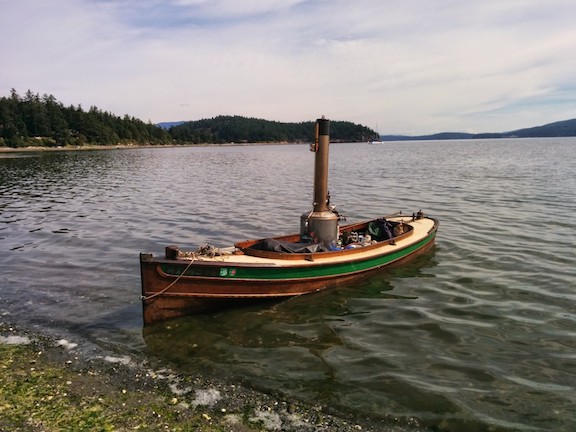

Otter's stack is titanium - 7" diameter APU tubing from Boeing Surplus circa 1989 or so. Since titanium is corrosion proof and naturally a muted gray color, I left most of the stack unpainted, and just paint the top 8" or so flat black w/ stove paint; this hides the soot that accumulates at the top of the stack very nicely. Otter's stack is not lined.
- otter.jpg (72.34 KiB) Viewed 14589 times
