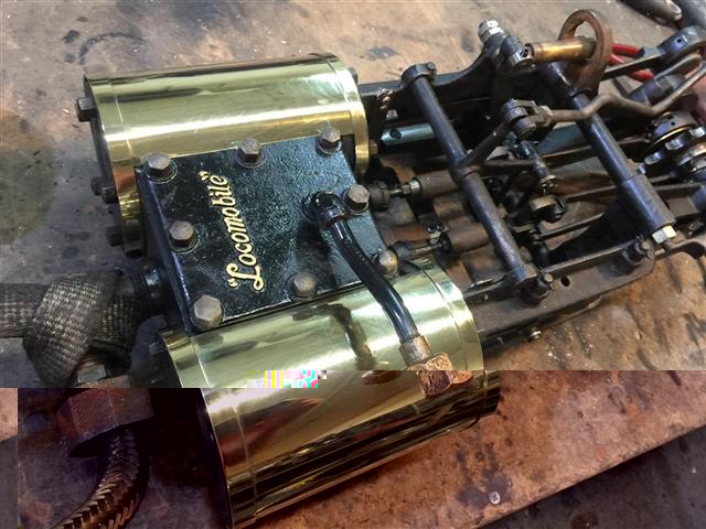

- IMG_2550 (Medium) (Small).JPG (68.36 KiB) Viewed 17261 times

Powdered graphite mixed into linseed oil that's been cut about 50/50with mineral spirits until its the consistency of maple syrup then painted on polishes up to a "black grey" that shines while looking impossibly dark when put on bare iron. Try it on a rusty piece of scrap, a couple thin coats then buff it a couple days latter after it has cured. You might like black after all. (Powdered graphite sold as dry machinery lubricant throughout the most farm stores or implement dealers)
Re: Engine Cast Steel Coating Options
Sounds similar to stove paste. It works alright on steel sched80 pipe and forged and malleable fittings. It lasts, but I'd say rustoleum is better. If we are taking the same thing maybe you have to apply it yearly...
