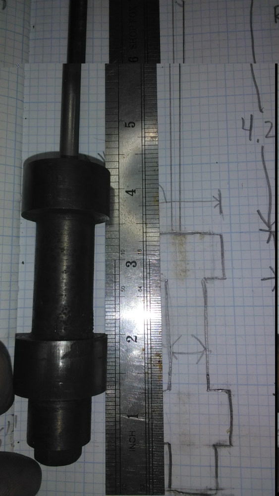

So it's looking pretty good. I was able to disassemble more then I expected without much trouble.
Here is one of the piston valves.

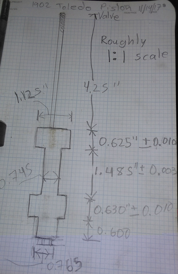

Re: 1902 Toledo Tuneup
Reading a little bit.
It is complex - what does the current valve represent...
What is the current "program"
See attached pictures ...
- Stock Toledo Valve
- st2.jpg (122.37 KiB) Viewed 10565 times
- Drawing of Stock Toledo Valve
- st1.jpg (117.28 KiB) Viewed 10565 times
Unfortunately the valve piston itself does not provide enough information; we need to know the port dimensions in the valve, the and eccentric throw. If you change the cutoff on the piston you will need to then also change the position of the eccentric on the crankshaft as well because your change will directly effect the inlet opening timing and that needs to be reset. I know that it is probably tool late now, but it would have been more ideal to work out the engine's valve events before you started pulling the engine apart. It can all be done in simulation but you need to first measure everything rather accurately. If you can provide all of the measurements I can help you to work it out, as I am sure can other here. I am afraid that I don't know your particular engine, does it have a Stevenson's link? Can I see a picture of the engine before you pulled it apart?
Lionel is right, The valve is only part of the picture, the ports, link lengths, mounting points all matter in the motion.
As worn as the parts of the engine that you showed are, I would really recommend not making any changes until you get all of the parts refurbished. The wear may be (is probably) having an adverse effect on the performance of the engine. Measure while it's apart, repair the worn items, see if that gets the result you want. You'll have a good baseline and the data to make good decisions on how to proceed. You would only be chasing your tail trying to change the events on a worn engine.
