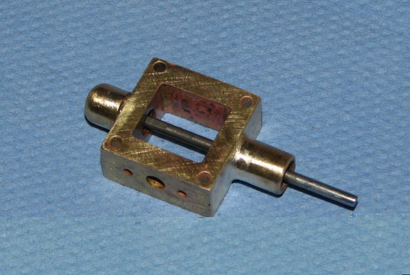

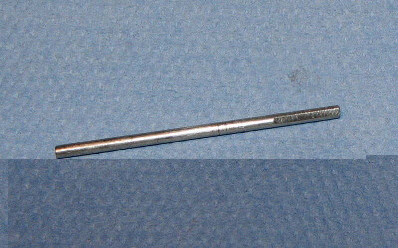

i prefer gunmetal for that part. The valve rod should have a small flat part a bit longer than valve stroke to prevent it from vacuum in the chamber above the rod.
Here some Pics.
The Valve rod
Valve rod in place in valve chest
