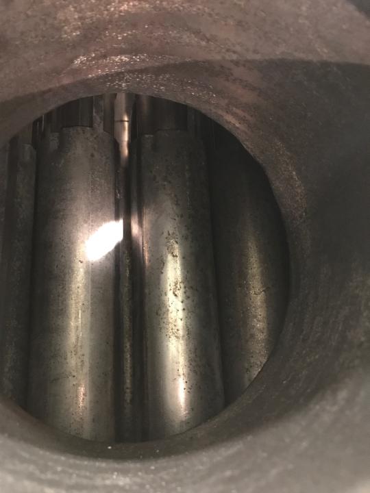

Here is a pic of the general thought (albeit from a NH3 system). It works remarkably well in that service, water however... perhaps with very little make up water.
- IMG950812.jpg (36.24 KiB) Viewed 11802 times

Thank you, that's why I asked. In the unit in the picture (taken through the vapor outlet) it has a very large separator drum above it, followed by a second vapor acumulator to prevent priming. Odd thing is that I've experimented running it fully flooded (i can raise the liquid level 3 ft above the tubes before it spills to the secondary seperator) and keeping the the level at the bottom of the outlet piping. I've repeatedly gotten consistent increases of 35% (measurments made in btu's) in vapor production when run at the lower end. I'm close to being stumped by it. (Data gathered by pumping fluid through the "firetubes" measuring incoming and outgoing fluid temps via rtd's, and flow rates with certified mass flow meters, while maintaining the same suction pressure in the vessel while it is filled with ammonia). I do believe there is something more occurring than just the increased static area. I fall back again to thinking it is the forming vapor "bubbles" sticking to the pipes and reducing their area when in flooded mode.
