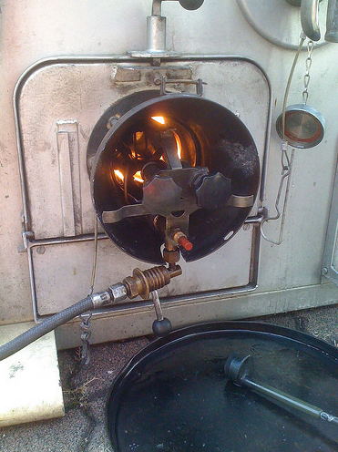

Here is a video of our friend, Ron Parola's steam launch "Victoria" and her Lune Valley fired Ofeldt boiler. He uses just regular deisel to fire it with great success. It took him several iterations and continually shortening the tubing, orifice sizes, and needle sizes before he finally found the right length where made plenty of steam and it didn't make the deisel get too hot and carbon up the burner. The lump in the centre is a 2" tow hitch ball to provide some thermal mass.

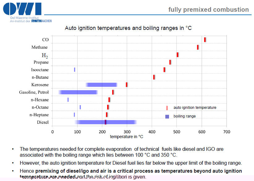

An important element with respect to vaporizing burners is illustrated in the attached graph. This is one reason why vaporizing burners with No. 2 (Diesel) oil are generally more difficult due to its vaporization range traversing its fire point, therefore mixing combustion air into the flow before you want combustion is not an option. Obviously No. 2 vaporizing burners can be successful, however I would prefer kerosene.
Gasoline also works well in this regard, but the low flash point temperature (100F, 40C) for gasoline introduces additional safety issues, so it is generally not appropriate for vaporizing burners in boats, although many steam automobiles successfully burn gasoline with vaporizing burners.

Fred,
That is a very interesting graph and concurs with my experience vaporizing Kerosene and Gasoline. Interesting to note that the upper boiling er vaporizing limit of Kerosene is considerably above that of gasoline, making it much less likely to create carbon. That I suspected but was unaware of, I do know that vaporizing Kerosene is much more difficult (lower limit), generally requiring a vaporizer with three times as much heating surface compared to gasoline.
On my car, I run straight Kerosene and the carbon issues (overheating) have been virtually nonexistent and the folks that run Gasoline, especially with ethanol have considerable carbon issues.
The guys that run their steam cars regularly typically burn a mixture of Gas and Diesel or Gas and Kerosene, finding a blend that suits their vaporizer for least hassle free driving.
Should be noted too, in range of heat, coldest to hottest by number of carbon atoms, it is Gasoline - Kerosene - Diesel.
Thanks for posting that.

Sorry to be stupid, but why the difference in potential "carbon" production ? Agree very interesting post, Thank you.

They're referring to the vaporizing burners... In those burners the fuel is fun through a tube which is impinged upon by flame to turn the fuel into vapor and make it easily ignitable. That heat, if too much for the fuel being used, will cause carbon to build up in the vaporizing tube and plug the burner. Stanley steam cars had a cable that was in the vaporizer that if pulled out would clean the carbon out if done regularly. If not, it got stuck and then you're really in a pickle. If the vaporizer is completely plugged with carbon one of the only ways to clean it out is to heat the tube to red hot and simultaneously run air through it to literally burn the carbon out of it. I've had to do that once on my launch "Wayward Belle"
They're wonderful burners if built right for the fuel being used (long, or short enough, vaporizer tube for gas, diesle, kerosene, or a mix) and regularly cleaned and maintained.
