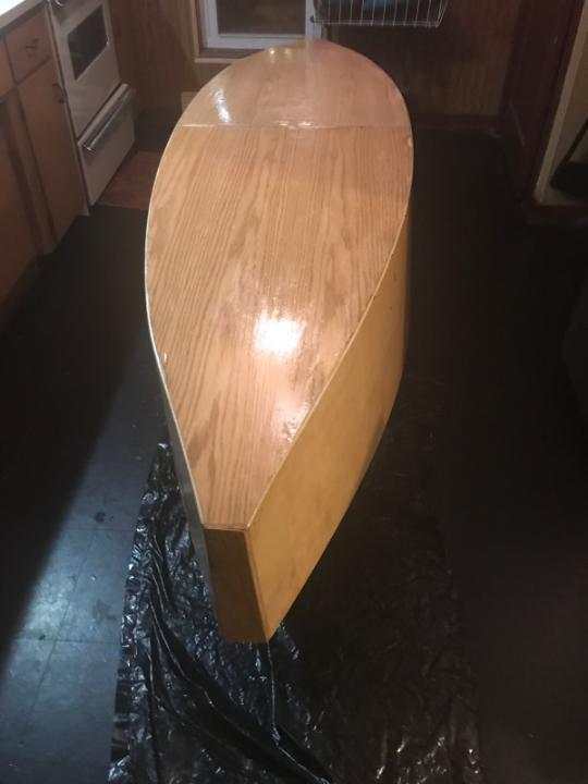

Cabin fever set in and I built a 8' practice boat in my house, the wife was not as impressed with the mess as my daughter was with her new boat. I just used west system epoxy on some oak and birch ply I had laying around, but since marine grade is unavailable locally and shipping costs are enormous, would it be feasible/are there common alternatives that work if I were to roll a few layers of epoxy on a full size boat.
ps. It doesn't show well in the pics but has 3" rocker and floats well
- IMG9512693.jpg (30.97 KiB) Viewed 11528 times

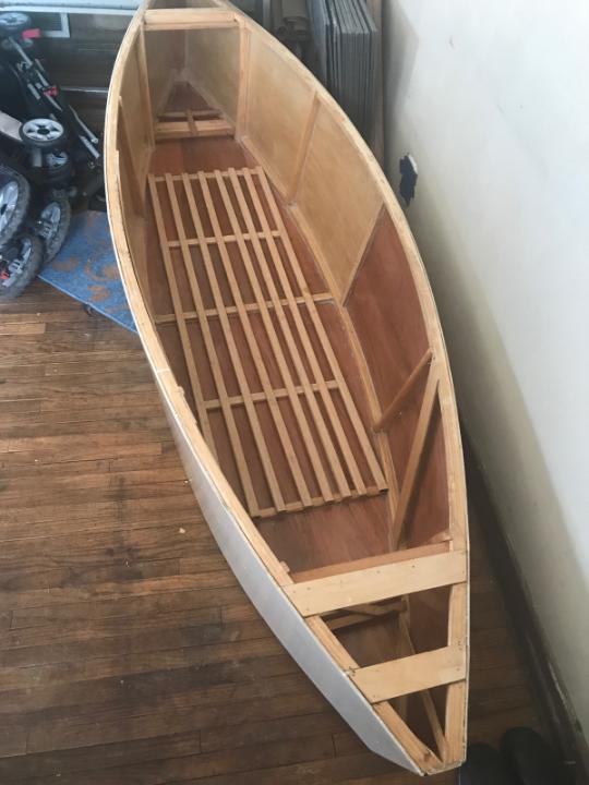

The first pic was after a layer of fiberglass, inside frame is radiata pine laminated bows with oak stringers
- IMG951313.jpg (48.57 KiB) Viewed 11526 times
