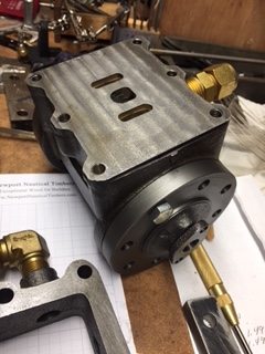

I am considering placing a plate on the slide valve seating surface, about 1/4 inch thick, maybe stainless steel, and making the slide valve from filled Teflon. This would allow replacement of the simple flat plate (with some ports cut thru) with various materials, and no need to resurface the cylinder casting due to wear.
Has this arrangement been used with success? With other material combinations?
Thanks in advance for any information here.

The only experience I've had with Teflon tells me that the finish on your metal plate has to be good. Maybe very good. I've used Teflon rings and even a whole piston on display engines meant to run on air with no lubrication. The first time when I tried to used the cast iron bore as machined the rings went away very rapidly. A polished surface using felt pads and abrasives working all the way down to rouge worked much better.
I don't know what the temperature v.s. deformation curve is like on your Teflon. Worth a try at any rate. It would be nice to have a setup where you could experiment with different port locations.

I can only reference you to my long running thread "And now for the Twin". On page 2, a photo shows the ones I've made in M.S. with the intention of using gun-metal slides. Almost inevitably the plate will wear first and worst. but an easy thing to replace.
I'm sure the plate would take a good polish finish if required.
