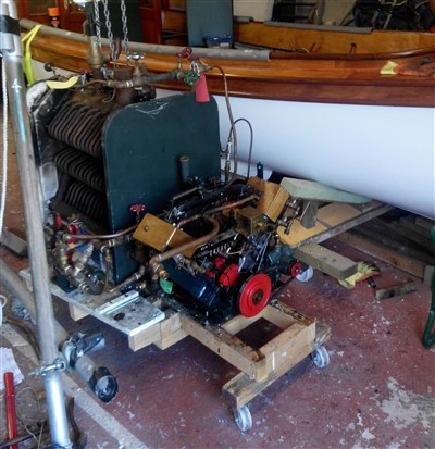

I'm not familiar with that particular boiler, but can sympathise with the problem of there being too little space for the body parts needed to deal with the job. Those of you with Rose hulls will not doubt agree.
My solution has been to create a trolley whose structure replicates the engine bearers in the boat, including the studs for mounting the engine. I was also luck enough to acquire an engine hoist (made of scaffold poles) which means it is easy to crane out the engine and boiler. That allows work on both over the winter with as much access room as one could ever require. Of course it is a bit of a pain disconnecting and later re-connecting all the pipework. Being on castors the trolley can be shifted anywhere in the garage or even outside for spray painting (yesterday's task).
Boiler on Trolley
Boiler on Trolley
Boiler on Trolley (400 x 413).jpg (56.86 KiB) Viewed 41081 times
