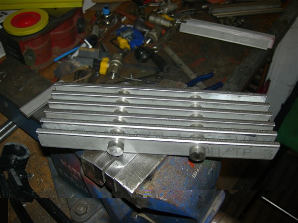

Re: Seeking lead on a Green Sand Cast Iron Foundry in Texas.
Mfoxchicago wrote:Fred, I got a quote on a SS bar grate configuration custom made to my dimensions that priced out at $4700. for five sections. CLEARY, I can't afford that option.
Fabricate from bar stock, very easy to do.
Grate (3) (600 x 450).jpg (70.23 KiB) Viewed 17955 times
Here's a third of one of mine. You can pick your own bar to air ratio and even change it later if you want. You can also make it in easy-to-fit sized pieces, or just one big one.
