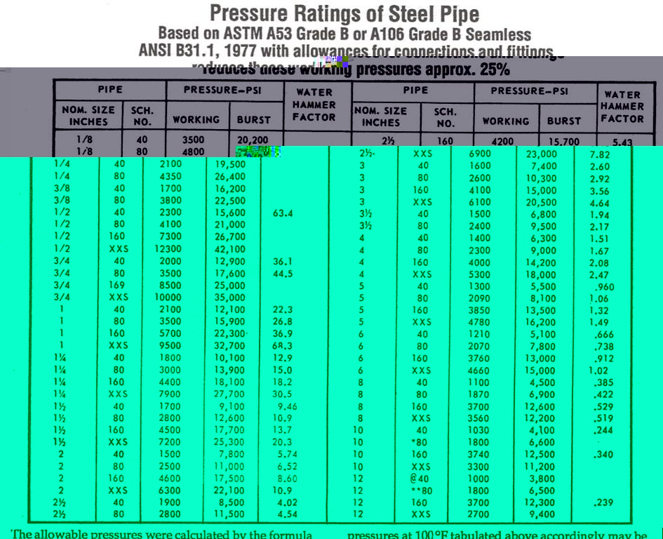

Any vessel that could be formed in that manner with only 2400 psi would not be safe for a boiler. Much of the tubing we use, larger shell material, smaller pipe etc has working ratings that high, the actual burst pressure can be many times that. For instance, 1/4" schedule 40 pipe if memory serves me correct has a 2400 working psi rating, but the burst pressure is over 10,000 psi, again if I remember correctly, but I'm not far off.
I see people doing this on youtube making ramjets etc, but keep in mind, any air trapped between the sheets when hydroforming will store energy and can expel components at high speed if there is a failure. It's essentially a bomb.
I found a chart, have a look for comparison.
- working.pressure.pipe (Medium).jpg (121.33 KiB) Viewed 6157 times

Okay, idea officially scrapped. Though I guess I never really though about saftey margins to ultimate fail as high as >100/1. Im more use to 1.5/1 or 2/1 on life critical parts in my other hobby (experimental class aircraft) but weight is much more of an issue there.
