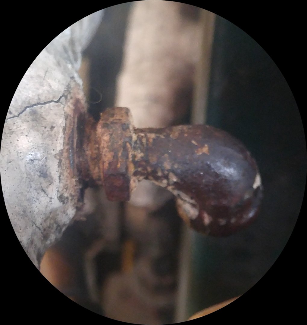

Good evening, somewhere I was told my cylinder lube oil which feeds from my lubricator up a copper tube, through a very small check valve, then into a fitting that is installed in the main steam line that is supposed to have some sort of "quill" style atomizer.....but mine does not seem to feed through the oil that my pump is delivering. The fitting is rather corroded. Before I tear it up attempting to extract it, can anyone send me a pic of what I need to be looking for on the inside of this assembly.

On the hydrostatic oilers there is typically (supposed to be, it's usually missing) a small tube that protrudes out to the center of the steam line. It is cut off on an angle i.e. "quill", the idea is to deliver the oil right in the flow of the steam rather than having it run down the inner side wall of the steam line. In practice, with or without it works.

It sounds as though Mack's oil comes from a pressure feed rather than a displacement oiler. In my book this is very good, because displacement oilers in my experience sometimes do work, but often give too much oil and adjusting them down results in none. A metering pump is more reliable. Like Ron, I think if the oil gets into the steam flow, atomising it isn't very important, and it'll get spread around the cylinders and pistons well enough just by running. There is an argument that says if the oil is NOT atomised, it is more likely to stick to cylinder walls, and not just carry on with the steam flow.
I have to say if I had a fitting that looked like the one in the photograph, I'd replace it. There would be no great harm in having a spray end to a new one, but it certainly isn't essential.

Thanks for the design insights. My lubricator is a Madison-Kipp Ratchet Drive oiler. The oil is delivering through the sight glass and making it's way up the brass feed tube to the brass check valve, the check valve is clean and operative - but I don't believe any oil is making its way in to the steam line because the sight glass fills with oil. I have reduced the flow rate down to almost nothing. I have tried sticking a very small zip tie up into the fitting that was pictured to try and dislodge any obstruction that might be clogging the quill.
Is there any possibility something could be clogging the quill? I may risk shearing off the old elbow fitting to see what is in the line, but just need to time it right so as to not lose us any operation time. Money is tight. I need her running and not sitting down for repairs just because I have a hair up my ...... you know. But I want to properly lube this 34yo engine so she'll last another 20 years.

I would pull that elbow and replace it. Although it looks bad, if it's been used for lubrication, the threads are probably free on it. And of course replace it, that's about a one dollar part.
I was commenting about the "quill" on the hydrostatic oiler above. If the oil is not entering the line and the pump is working, then yes there is some sort of obstruction.
Everyone has different experiences, but all I use are Hydrostatic oilers and they have been very reliable with no moving parts. The way to adjust them is the "oil" valve just cracked off seat. The old directions say one turn, but that was before they were over-tightened a thousand times over the years and the needle and seat were stretched out of shape.

Now an update - I FINALLY got most all of the old steam welded fitting out. Can't say what type of "quill" I had, if any. Most all of what ever was there had to be drilled out to fit a square extractor bit in there. Prior to drilling, the tiny channel kept getting smaller and smaller as it extended in to the steam line. Nothing like the quill of a fountain pen...??? Now, where can I find or what should I call the part by name to ask the local specialty plumbing guys for....???

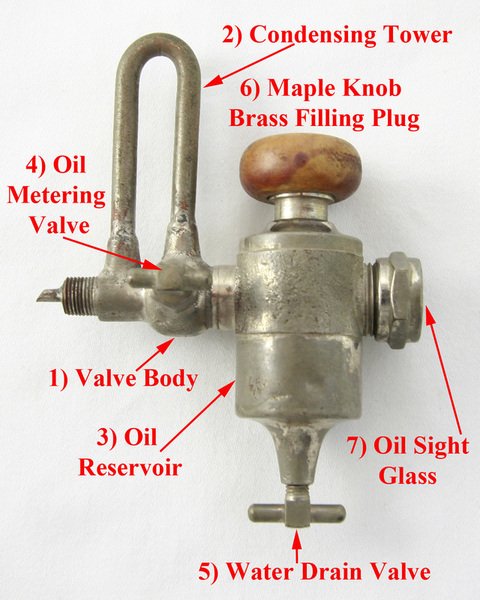

Judging by the picture you posted, it looks to be simply an elbow connected to the steam line for administering oil, there was no "quill". If that worked, I would just put it back like it was determine the reason the pump is no longer delivering oil. If you look at the pipe threads on left that is the quill which atmoizes the oil in the center of the steam pipe. it's not imerative to have it, most oilers don't have one that I've seen.
