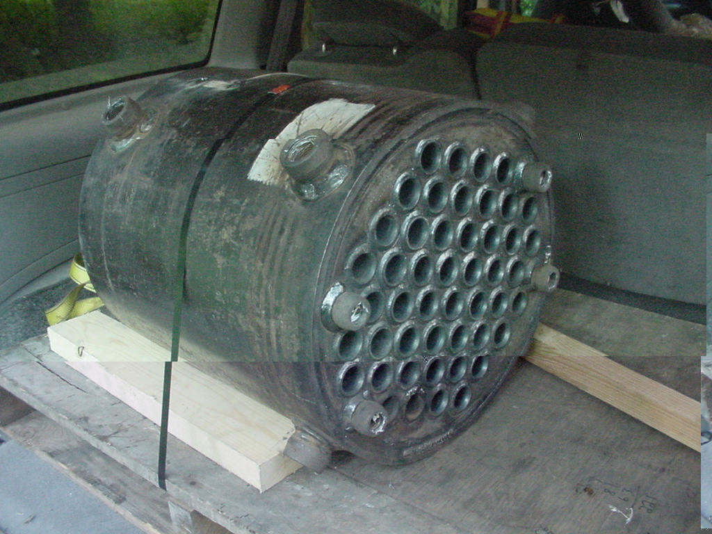

Re: American Walking Beam Engine
Just got the new ASME Code Boiler last week, Vertical Firetube type, 48 tubes, 18 inches long, 1-1/4 inch Outside Diameter, 0.095 inch wall thickness of tubes. Shell is 16 inch diameter x 0.375 in wall, 20 square feet heating surface. The prices I got to weld the boiler together and provide ASME Code stamp ranged from $7400 to $890.
Sidewheel Steamer Boiler
Boiler ASME M.jpg (141.55 KiB) Viewed 38961 times
Fred,
Nice looking boiler. Was the "$890" a typo?
The engine is beautiful..
Thanks, Ron

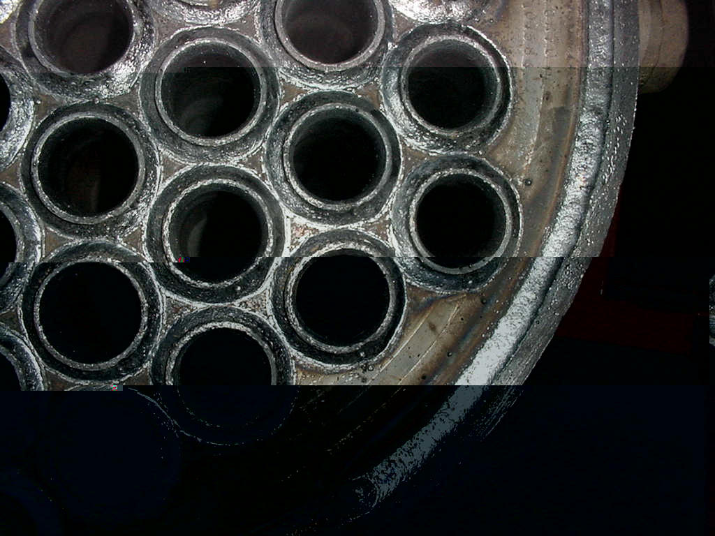

No, the $890 US is not a typo, and that was the ASME Boiler shop I selected to do the job. I am very pleased with the job. Passed the 300 PSIG hydro test with no problems. I have owned several welders since the early 1970s, but my welding skills don't come close to those of the ASME certified pressure vessel welders. The welds, to me, look like artwork.
Wow that is a great deal! Yes, looks like they did a nice job on it.
Ron
Tube to tubesheet welds, tubesheet to outer shell welds, very good work.

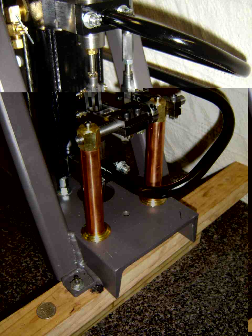

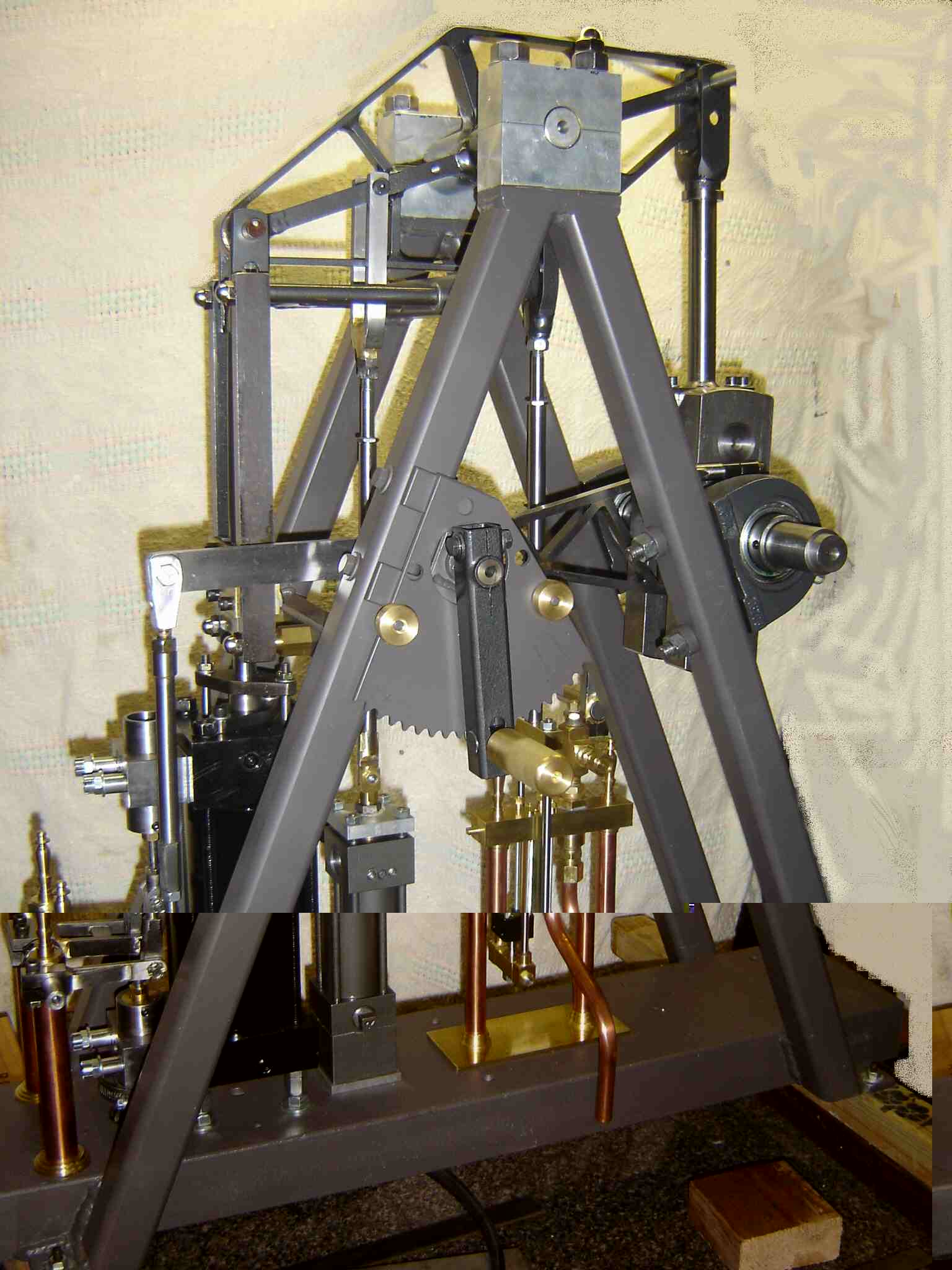

Somehow the Engine Picture was lost, so here is another post of the engine pictures
1 HP @ 100RPM Nominal
Piston type slide valves are moved by Rocking Shaft
Engine RockShaft-SteamPipes small.jpg (72.44 KiB) Viewed 38837 times

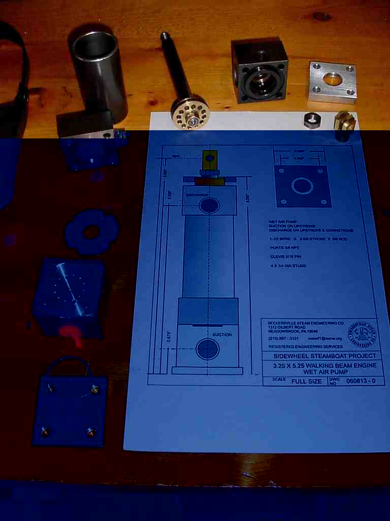

Wet Vacuum Pump operates at 1/2 main piston stroke
Engine WetVacuumPumpParts small.jpg (42.69 KiB) Viewed 38837 times
