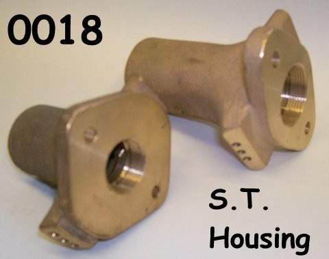

I’ve been advised both ways, but the local consensus is towards a cutlass bearing and I respect their advice ... and yours to.
So a cutless bearing it’ll be.
Something like this.
Thanks
Thanks
