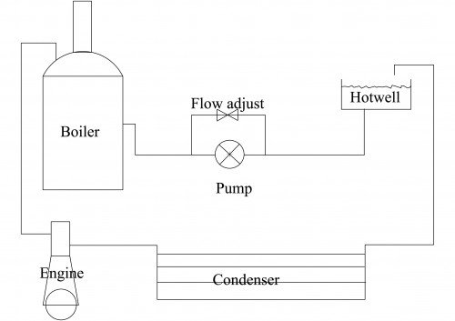

What has worried me is whether I am understanding the condensing circuit correctly. This is a pictorial representation of my understanding:
This is for a simpler condensing circuit with no air pump. The idea is that the back pressure from the engine exhaust should be enough to push the condensate up to the hot well. The little loop with a valve around the engine driven pump is to adjust the flow from the pump which could be a touch too much.
If that is conceptually correct I can press on with working out the pipe runs.

Pete,
the back pressure on the engine will be around 1.2 psi for every 3 feet of lift, so certainly no need to worry about that. What could be a problem (and this is just me theorising [AND without a pint in my fist] ) is that the condenser could fill up with water, and therefore not have enough cooled area to condense the incoming steam. Someone else may have tried the set-up, and found a way round the potential problem - if indeed there is a problem. Mounting the condenser elements slightly higher than the hotwell might just be possible if the hotwell goes right down into the bilges.

I wouldn't plumb it that way. You would miss out on one of the very nice advantages of a hot well. Self regulation of the boiler water level.
The output of the feedwater pump should split in two directions. One into the boiler through the obligatory check valve and shutoff valve, and the other direction going through a seldom used valve and to a float valve in the hot well. Forget that regulating valve that you show bypassing the pump. The 'seldom used' valve can duplicate that function in the odd chance that the float valve should stick in the open position. Mine never has.
I find good float valves in farm supply outlets. They are used for animal watering tanks. My safety valve set point is around 140 psi and a common float valve has been in operation for years with no problems.
I don't know about other people's experience but I have had no problem with the engine output keeping the water out of the condenser. I have a keel condenser that is maybe 30cm. below the float valve.
My feed water pump has enough capacity to always have a significant flow though the float valve. In fact, I have it where I can keep an eye on it.
In case this is a new idea to anyone reading this, The theory is that since the total volume of water in the combined hot well and boiler is a constant except for leakage, safety valve operation and whistle use, regulating the hot well level automatically regulates the boiler level.
I find that when my system is reasonably leak free (all too seldom) and I'm half way attentive to the set point of my safety valve (again not often enough) and not spending half my time irritating everyone with the whistle, the water on my level gauge is so constant that I get careless about keeping an eye on it. Like many things, a mixed blessing.

"the condenser could fill up with water, and therefore not have enough cooled area to condense the incoming steam. Someone else may have tried the set-up, and found a way round the potential problem - if indeed there is a problem."
If water is not flowing into the hotwell, it must collect in the condensing tubes of the keel cooler, then the heat transfer surface area is reduced (because steam has less surface area in contact with the sea water cooled condenser tube), less steam is condensed, and exhaust pressure increases. As previously stated, about 1 PSI pressure increase will force the water out of the condensing pipes and up into the hotwell. This is a self regulating condition, and exhaust steam will always build up enough pressure to force the water into the hotwell, even if the hotwell water level is a couple of feet above the condenser. This clears enough condensing surface area to allow the condenser to do its job.

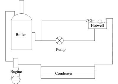

Many thanks for your wisdom everybody. Thanks especially to Mike for spotting that I had omitted the loop back to the float valve in the hot well. That idea had been in my head at some point as my box of 'bits to fit in due course' include a diminutive float valve, but the idea must have floated away by the time I got around to drawing the logic. So here is the corrected version:
Condensing Concepts 2 (400 x 283).jpg (11.66 KiB) Viewed 30421 times
Thanks also for discussing the issue of flooded condenser pipes and the height to which back pressure will push the condensate.
I have plumbed the exhaust line in 22mm pipe and then used 15mm for the line out of the condenser towards the hot well. I should say 'will use' as the run that I have already installed will have to come out as I routed it for the hot well on the right of the boiler but it will now need to go on the left. My thinking was that the condensed water will be a lesser volume than the steam so a smaller pipe should be adequate. The outlet pipe goes to the bottom of the boss and is perforated so that a very small amount of water needs to collect in the condenser to cover the outlet. The condenser is two lengths of (I think) 22mm pipe with a cast bronze boss at each end and an overall length of something over 1m. (If Greg is still monitoring the site he may recall the exact details. Currently I am on location with relatives so the boat is not to hand for measurement).
