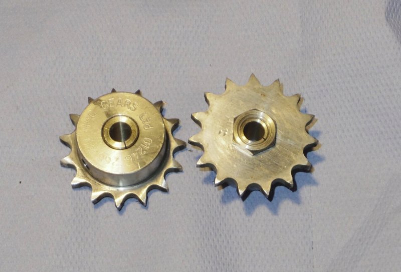

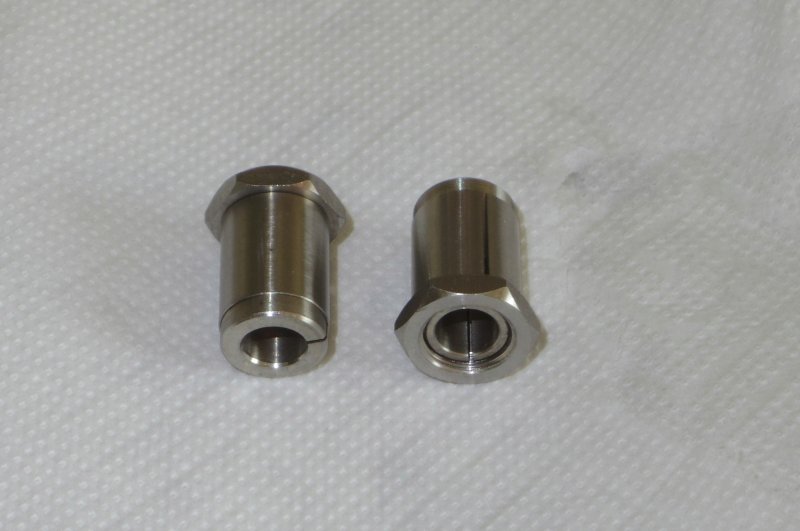

i have used locking assemblies BAR and SIG
locking Assemblies SIG
I have bought them at www.maedler.de.
Best Dietrich

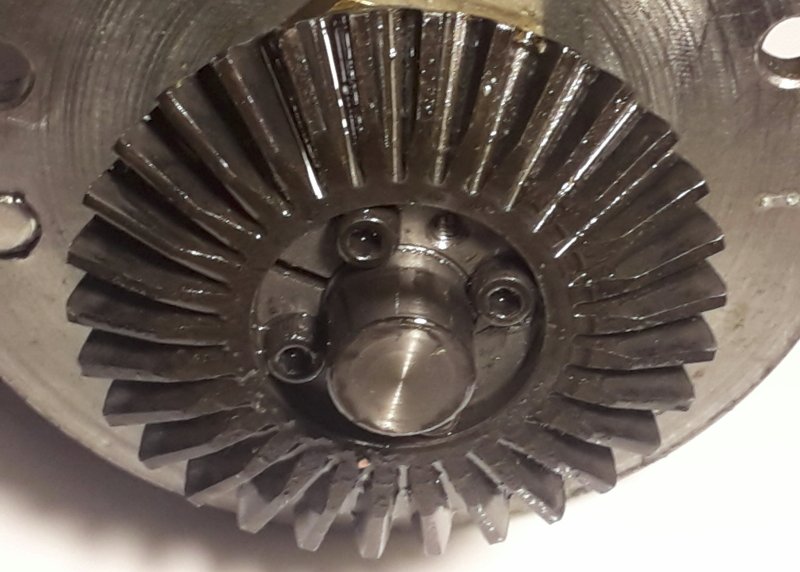

I have used "Po-Boy" keys many times, with great success.
A tap drill is used, drilling parallel to the shaft centerline at the intersection of the shaft outside diameter and the driven component inside diameter. Tap deep enough for two set screws, run the first one down hard, followed by the second one, with some Loctite.
These can be taken apart, and re-assembled, although this can be difficult because precise alignment before replacing the set screws is required, especially if the shaft fits are tight.
The cranlshaft on my walking beam engine is fitted this way, with a maximum running torque of 270 ft-pounds applied to the crank. The picture shows two "Po Boy" keys using 1/4-28NF set screws on a 1-1/4 drill rod shaft. (nearly 6mm x 1 set screws on 32mm shaft)

Thanks for your contribution, too. I remember now seeing this alternative to key-way-cutting and I asked myself if this would really be sufficent to prevent a crankshaft from twisting - or more accurately spoken: from the crank pin to slip on a sub-degree-level, that would already cause a misalignment of both sides of the crankshaft. But it seems to work on your engine. I was always concerned about that with any sort of keyways in general and thought that's the reason they are not used for crank pin-to-web connections.
