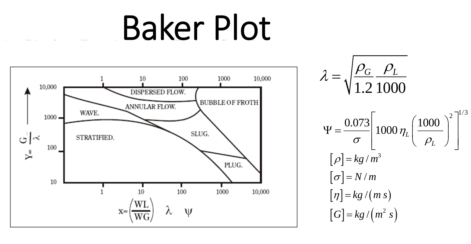

I suspected the slug flow, annular flow and dispersed bubble flow, but in no way would I've thought it might be that complex.The scientist in me wants to calculate all the conditions of the medium throughout the system. But before I sink into theoretical spheres all too deeply, I'll stick with a basic calculation of speed and pressure drop for pipe sizing.

So the conditions within the coil traverse from a very docile 2 feet per second liquid flow inlet, which itself is very turbulent, up to a far more turbulent two phase mist flow at the exit. I have found no experimental data on the flow conditions within the coil (similar to the Baker Plots, which only address horizontal and vertical flow), because the coil centrifugal action will tend to throw the liquid droplets to the outside of the coil radius, leaving a higher fraction of steam on the inner radius of the coil. I hope burnout will not occur, and that turbulent mixing will keep the steel coil from overheating by keeping it wet with liquid water mist.

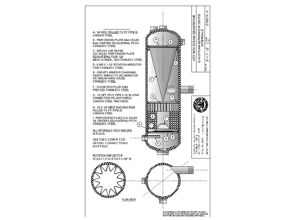

The outlet of the monotube coil is a two phase (steam and liquid water) mixture, and it is necessary to separate the steam and water, sending the steam to the engine, and sending the hot water to heat revovery system. The attached picture shows the internals of the separator, with tangential inlet, allowing centrifugal force to do this function.
- SEP-INTERIOR.JPG (109.84 KiB) Viewed 10756 times

This is really neat, Fred!
That coil set up would be very nice for a Le Mont boiler as well; the use of the high speed flow could be used w/ a tangential entrance to generate a violet circular motion in the drum, and with a tangential feed at the bottom of the drum to circulation pump one could pick up substantial amounts of dynamic head to help prevent cavitation in the circulating pump.
